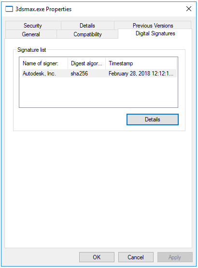

The digital signature for executable files can be accessed by right-clicking the file, clicking Properties, the Digital Signatures tab, the name of the signer and the Details button, and then View Certificate. Note that the file extension must be .DLL for this to work, so the recommended approach is to make a copy of the file and change its extension to .DLL, then check the File Properties.
For example, this is what this File Properties dialog looks like for 3dsmax.exe:
