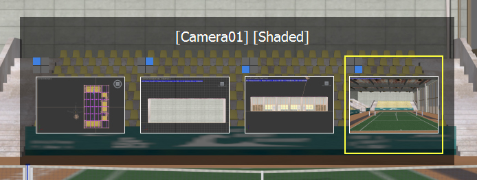

When viewports are not maximized, pressing (the Windows logo button, sometimes labeled "Start") + Shift cycles the active viewport. When one viewport is maximized, pressing +Shift displays the available viewports, and you can press +Shift to cycle among them: When you release the keyboard buttons, the viewport you chose becomes the maximized viewport.
Overlay thumbnails for switching the maximized viewport
