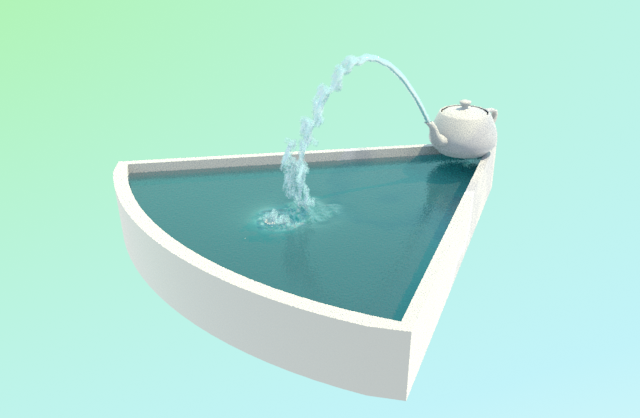

Fluids
Using Fluids, you can simulate the physical properties of such liquids as water, oil, honey, and lava as well as replicate the effect of gravity, collisions with objects, and disruptions by motion fields in order to achieve your desired result.
