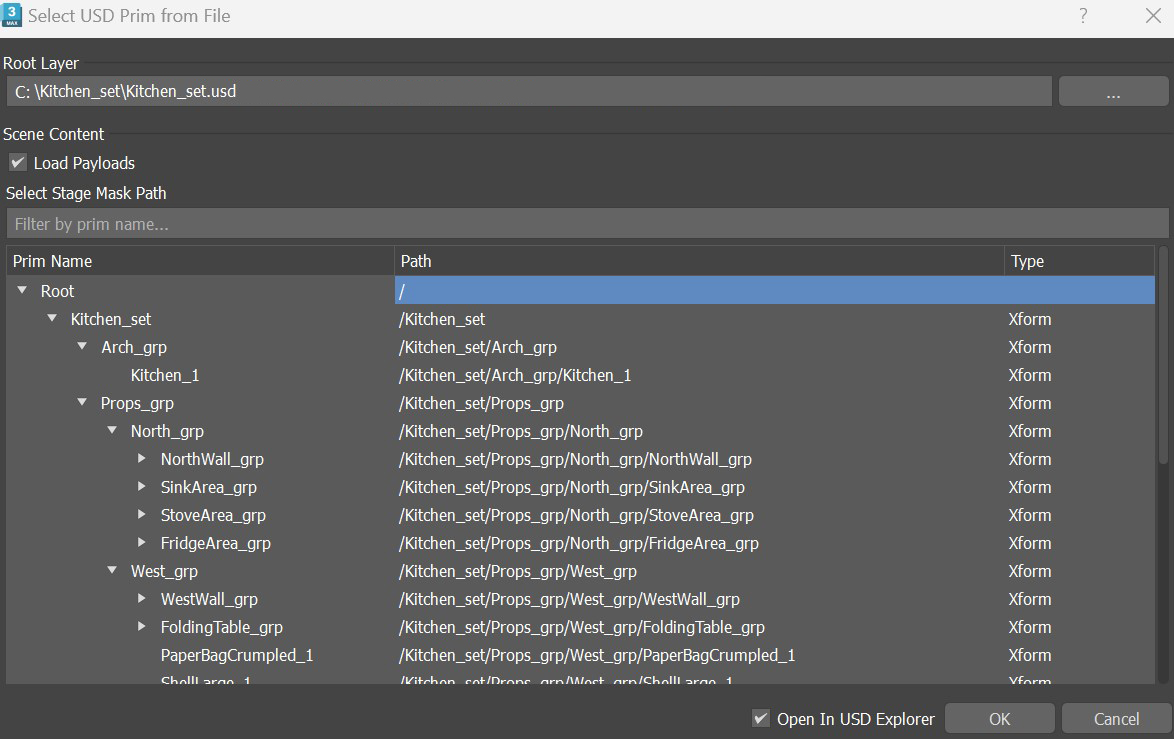

  1. Use the Select USD Prim from file dialog to build the scope of your USD reference.
    • Verify the Root Layer is your chosen USD reference path.
    • Use the Load Payloads toggle to choose whether to load the payloads in your USD stage. By default, all payloads are loaded.
    • Select a prim to only display it and its descendants in your scene. This will apply a Stage Mask filter to your display.
      Note: Certain prim types are unavailable for mask selection. Materials and GeomSubsets are not included. Any prim outside this mask hierarchy will be excluded from the stage, including referenced data like materials. See the Pixar USD API documentation on Stage Population Mask.
    • Ensure you have Open in USD Explorer selected so you can immediately view a tree hierarchy of your scene make edits to visibility and more for your USD Stage.

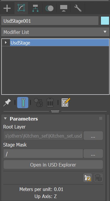

  2. Use the Parameters Rollout in the Command Panel to configure or make changes to your USD stage reference at any point.
    • Select the ellipses (...) next to the Root Layer label to select or change your referenced USD file.
    • Select the ellipses (...) next to the Stage Mask label to choose the prim and all descendants you want to display in your scene. You can use Stage Mask to configure your display and mask prim objects you don't want to display in the viewport.

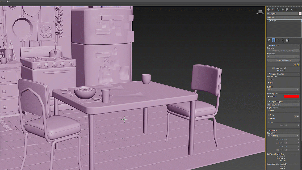

Transform the prims in the USD stage
You can move, rotate and scale prims in the viewport while in the prim sub-object mode.

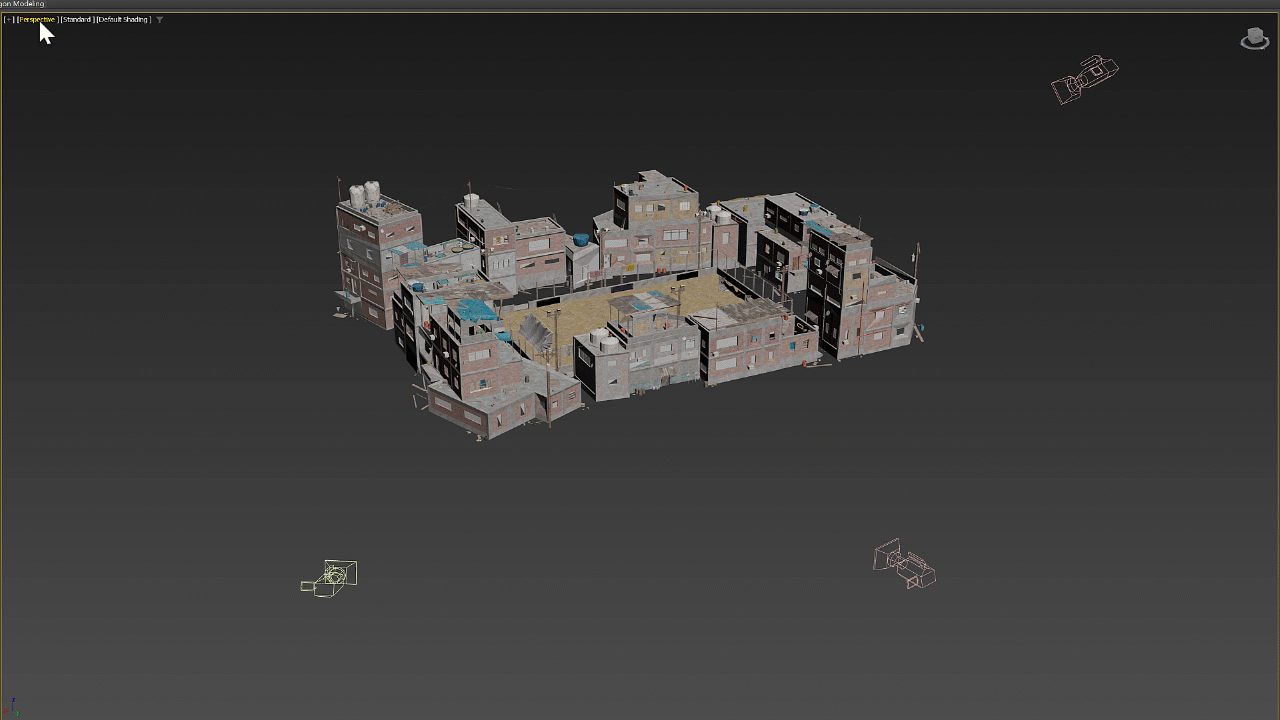

Use the USD cameras inside the Viewport
You can use the cameras in a USD stage in the viewport. To set the view to follow a USD camera, you can choose either of the following methods:
  • Go to Perspective > Cameras, and select the desired camera.
  • Select the camera in the viewport, right-click and choose Set View to Selected Camera.
