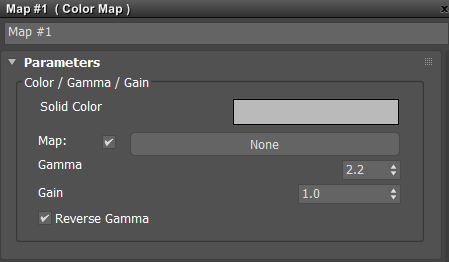

To color a map:
  1. In the Color Map Parameters rollout, click the Map button marked None.
    The Material/Map Browser opens.
  2. Select the map you want to colour.
    Note: Alternatively, you can use the Slate Material Editor to wire a map to the ColorMap component.
  3. Click the Solid Color swatch.
    The Color Selector dialog opens.
  4. Choose a new color.
  5. Set the Gamma and Gain values.
  6. Select Reverse Gamma if required.
Interface
Color/Gamma/Gain group
Solid color
Opens the Color Selector: Solid Color dialog, where you can select the color using RGBA values, HSV values, or by clicking on the desired color.
Map checkbox
Toggles the effect of the map.
Map button (None)
Opens the Material/Map Browser.
Gamma
The gamma value applied to the input.
Gain
The multiplier for the input.
Reverse Gamma
When off, the map multiplies the input by the gain value, and then applies a gamma correction to the color. When on, the map applies a reverse gamma correction to the color and then divides it by the gain.
