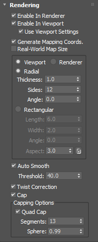

When you use a shape to create an object by lofting, extruding, or other means, the result is a renderable 3D object. Alternatively, you can render a shape without first making it into a 3D object. Follow these steps to render a shape:
  1. On the Rendering rollout of the shape's creation parameters, turn on Enable In Renderer.
  2. Choose the cross-section type: Radial or Rectangular. Then adjust dimensions and other settings according to your needs.
  3. If you plan to assign a mapped material to the spline, turn on Generate Mapping Coords.
When Enable In Renderer is on, the shape is rendered using a circular or rectangular cross-section. Mapping coordinates are generated with U mapped once around the perimeter and V mapped once along the length.
3ds Max provides control over renderable shapes; viewports, including wireframe viewports, can display the geometry of renderable shapes. You can have different rendering settings for the viewport, or use the same as for the renderer.
The Steps settings affect the number of cross-sections in the renderable shape.
Please observe the following:
  • When you apply a modifier that converts a shape into a mesh (such as Extrude or Lathe), the object automatically becomes renderable, regardless of the state of the Enable in Renderer switch. Enable in Renderer is necessary only to render an unmodified spline shape in the scene.
  • As with all objects, a shape's layer must be both visible and renderable for the shape to render.
  • The Object Properties dialog also has a Renderable switch, which is on by default. For a shape to render, both this switch and the Rendering rollout Enable In Renderer switch must be on.
