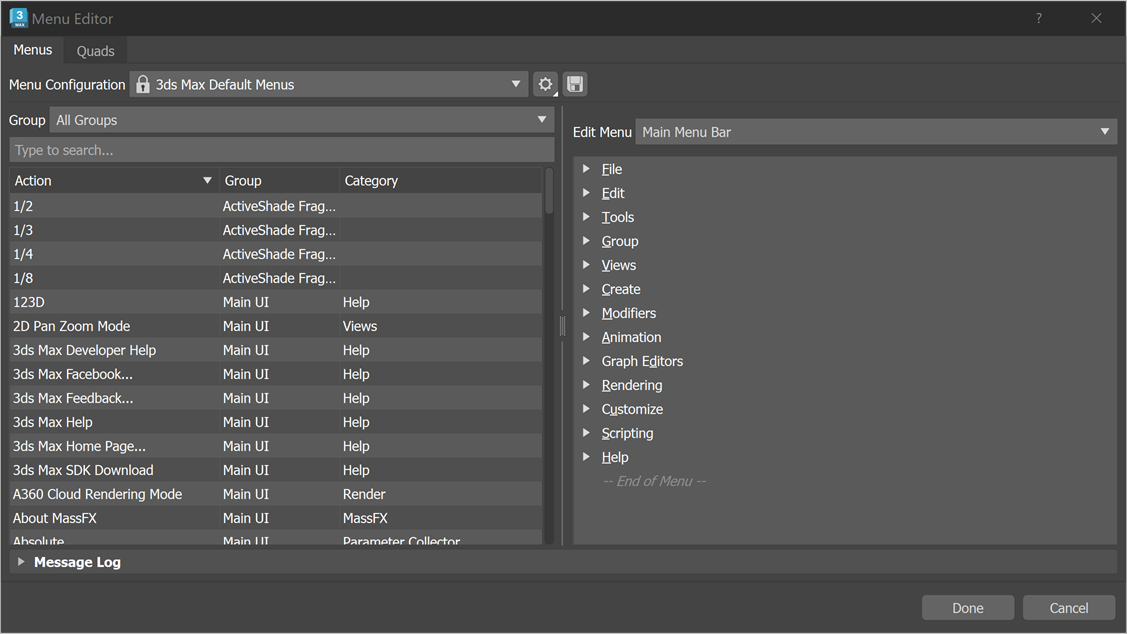

Menus Tab
- Menu Configuration
- Lets you choose the menu configuration to edit.
- Group
- Action items are organized into groups related to their feature area. This drop-down lets you specify which group of action items to look at.
- Search Field
- Lets you filter the list of action items by keyword.
- Action List
- Lists action items by name, and including their group and category, where assigned. From this list you can right-click items to see where they are used in the menu tree, and to edit their underlying macroscripts. You can also drag items from this list into the menu structure on the right to create a new menu item.
- Edit Menu
- Lets you select a menu to edit.
- Menu Tree
- Provides a tree view of sub-menus and menu items in the menu selected in the Edit Menu list.
Quads Tab
- Quads Configuration
- Lets you choose the quad menu configuration to edit.
- Group
- Search Field
- Action List
- Lists action items by name, and including their group and category, where assigned. From this list you can right-click items to see where they are used in the menu tree, and to edit their underlying macroscripts. You can also drag items from this list into the menu structure on the right to create a new quad menu item.
- Edit Quad
- Lets you edit the selected quad menu. In this list you can add new quad menu items, as well as rename, re-order, and delete existing items. You can also create sub-menus and separators. You can right-click an existing item, and view its corresponding action in the action item list.
