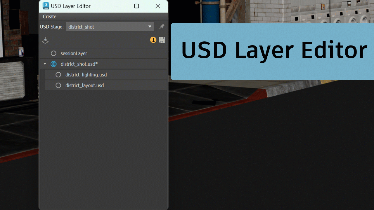

Layer Editor. USD for 3ds Max 0.10 introduces the Layer Editor, giving you tools to handle USD layers more efficiently.
