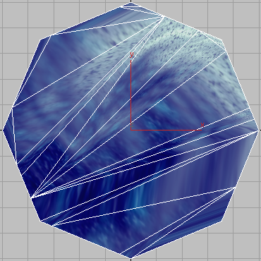

Original model
Vertices: 557
Merge Faces turned off
Vertex % = 25.0
Vertices: 139
Faces: 214
Merge Faces turned on
Vertex % = 25.0
Vertices: 23
Faces: 21
When a model has coplanar faces, Merge Faces can greatly improve optimization.
