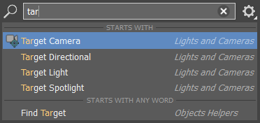

To search for an action:
- Type in the first few letters of the action.
The dialog displays a list of actions whose name matches the string. The Search prioritizes search results by actions that begin with the typed letters in the Starts With section, followed by any combination that contains the entered text string in the Starts with any word list.
In the example below, the entered string "tar" first shows words that begin with Tar, like Target, and followed by "Find Target".
Searching for the phrase "tar"

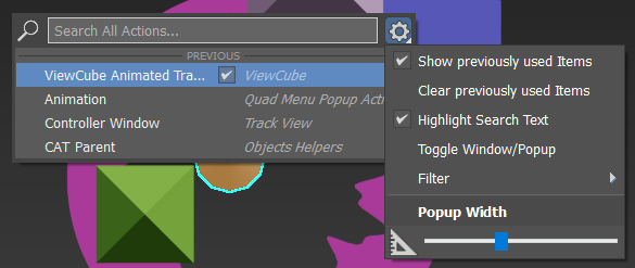

Search settings
The Search settings
gear icon next to the Search field to expand the Search settings.
- Show previously used items
- Check to show the history of last five used actions. This option is on by default.
- Clear previously used items
- Removes the list of last used actions.
- Highlight Search Text
- Shows the entered search characters in a different color than the search results.
- Toggle Window/Popup
- Switches from the pop up dialog to a window.
Tip: You can dock the search bar window into the 3ds Max interface. Once toggled to a window, right-click the window > Dock > choose from Top, Bottom, Left or Right to dock it and have it accessible at all times.
- Popup Width
- Lets you adjust the length of the Search pop up, which is better for searches with longer item names, for example Create Standard Camera from View.
