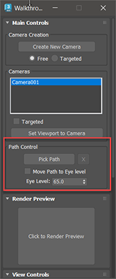

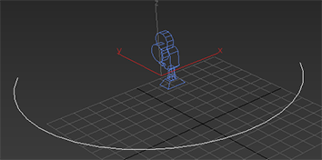

Animate a Camera along a path
You can create a path for the camera to follow using the Walkthrough Assistant.
- Add a camera to the scene. (Create > Cameras > Free Camera).
- Create a path in the scene using a spline shape or a NURBS curve (Create > Shapes > Arc).
Note:- Text and Section are not recommend shapes for creating a camera path.
- Create smoother camera movement by setting the spline shape Creation Method Smooth or Bezier instead of Corner.
- Open the Walkthrough Assistant. Default menu: Animation menu > Walkthrough Assistant > Advanced Controls rollout. (Alt menu: Animation menu > Tools (Animation Set) > Walkthrough Assistant > Advanced Controls rollout. In the Path Control group, click Pick Path, then click the path you created. The camera snaps to the path you created.

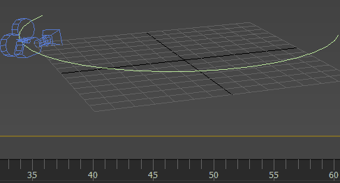

- Rotate the Camera to face the direction you want.
- Click Play or scrub the time slider to see the camera move along the path.
