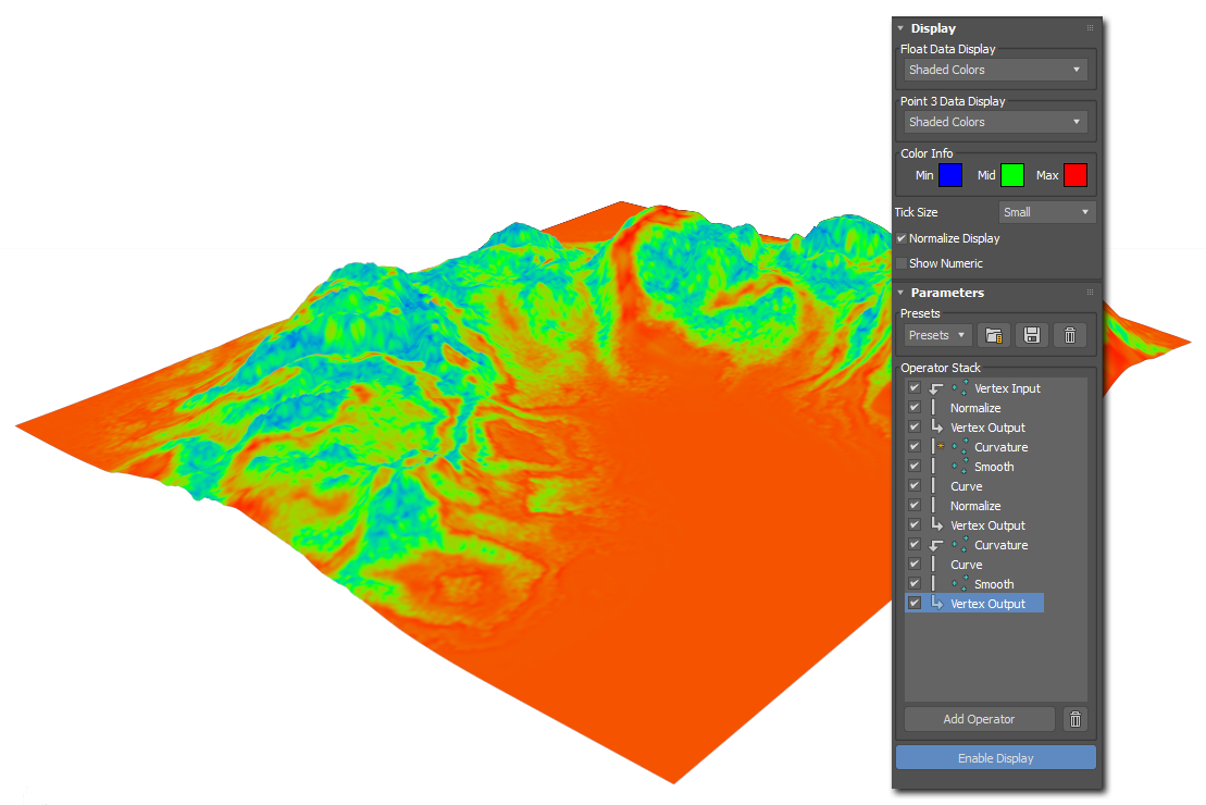

The Data Channel modifier is a versatile tool for automating complex modelling operations. By piping mesh data through a series of controls, you can achieve a huge variety of effects that dynamically update as you make changes.
An example of the Data Channel modifier being used to isolate specific topographical features using curvature data. This process stack could be used to mask off areas for convincing snow accumulations, for instance, that would update automatically after any further modelling.
About the Data Channel Modifier
3D objects are made up of various subcategories of data that define attributes such as geometry, vertex color settings, world coordinates, selections, and texture mapping information. The data for each subcategory is stored in a separate channel. Using the Data Channel modifier, you can apply various processes to various data channels as they flow through a stack. Any transformations will then update automatically as the object changes state.
The Data Channel modifier can be useful for automating such tricky operations as blending materials based on different states, creating deformations based on an output, or dynamically copying data between channels for storage. Data can be visualized directly in the viewport as gradients of color.
Data channels are manipulated through the use of components called Operators. Added operators are arranged in a stack in the Data Channel modifier panel. The data channel is then procedurally processed as it flows down the list of operators from top to bottom. Operators can be dragged and dropped in the stack to change the order of applying processes.
