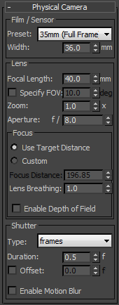

Sets the camera's main physical attributes
  • Create panel > (Cameras) > Object Type rollout > Physical > Physical Camera rollout

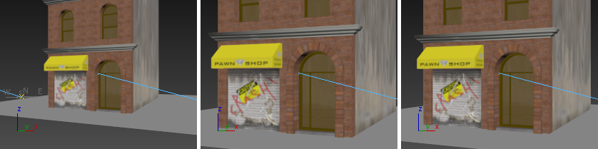

Left to right: 35mm, APS-C (Canon), APS-C (Nikon, Sony, etc.)
Film/Sensor settings
Left to right: APS-H (Canon), Four Thirds

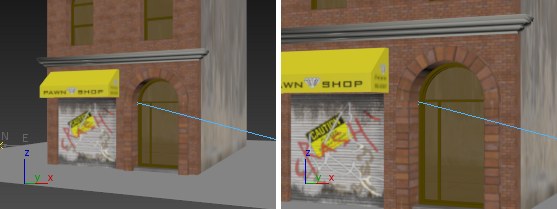

Zoom
Zooms the lens in or out without changing the camera position.
Zoom provides a way to crop the rendered image without altering any other camera effects. For example, changing the Focal Length changes the bokeh affect (because it changes the aperture size), while changing the Zoom value does not.

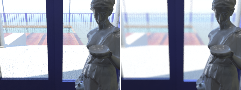

Enable Depth of Field When on, the camera generates blurring at distances not equal to the focus distance. The strength of the depth-of-field effect is based on the Aperture setting. Default=off.
Left: No depth of field
Right: Shallow depth of field (Aperture = f/1.4)

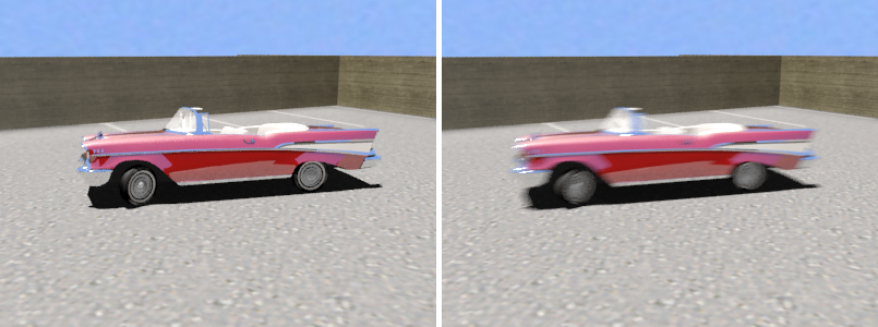

Enable Motion Blur
When on, the camera generates motion blur. Default=off.
Left: No motion blur
Right: Default motion blur (Duration = 0.5 frame)
