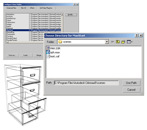

File dialogs (such as Open, Save, Save As) uniformly remember the previous path you used, and default to that location.

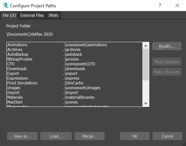

Configuring File Paths
The locations that 3ds Max searches to locate all file types are specified on the Customize menu
Configure Paths dialogs.
You can choose to open and save files in any path location. The Configure Paths dialog contains four panels for the general categories of support files.
Setting General File Paths
The File I/O panel contains paths for most of the standard support files. You can specify one path for each of file types 3ds Max uses.
