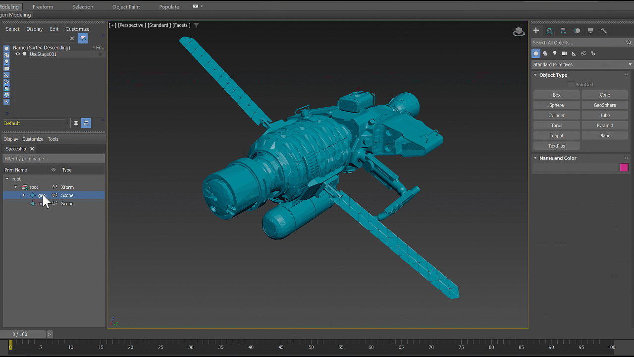

USD for 3ds Max 0.11 introduces the Promote to 3ds Max Object feature, enabling artists to work with geometry using native 3ds Max tools.
You can now promote a USD geometry to a 3ds Max object to work with it using native 3ds Max tools.
