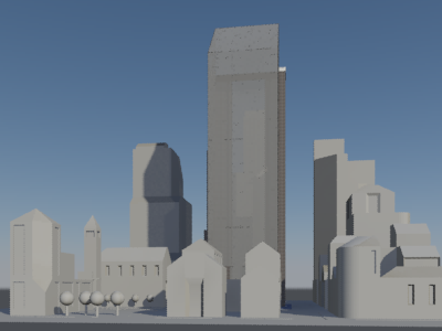

Left: No correction; Right: Vertical correction = 0.3
