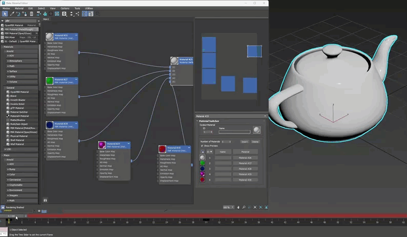

Adding Materials to Material Switcher
There are two ways to add materials to Material Switcher.
  • You can add a new material to Material Switcher by selecting the None button from the list.
Animation of adding a new material to Material Switcher by selecting the Done button.
  • Or, you can add existing materials by wiring your material nodes to the Material Switcher nodes in the graph editor.

Creating an animatable material using Material Switcher
If you have many material variants in Material Switcher, you can animate the Output Material ID spinner to let you swap between up to 9,999 materials. This let's you control the overall visual output of your materials in the viewport and renderer.
To create an animatable material with Material Switcher:
  1. First, ensure you have multiple materials applied to Material Switcher.
  2. Set the Output Material ID to 1.
  3. At frame 0 in the timeline, select the Auto Key () button. This will let 3ds Max to add a keyframe for the Index with a value of 1 at frame 0, once we add a keyframe at another time.
  4. Let's say you have a total of five materials applied to Material Switcher. Move to the keyframe 4, and change the Output Material ID to 5.
  5. You will then have Output Material IDs 1 through 5 automatically applied to keyframes 0, 1, 2, 3, and 4.
  6. From here, you can scrub the timeline with the Time Slider and view your keyframed materials in the viewport or renderer.
Note: The Index spinner prevents you from exceeding the maximum number of slots in the Material Switcher. For instance, if you set a keyframe greater than the number of materials in the Index, the last valid Material Switcher Output Material ID will be used as the keyframe, effectively "clamping" the animation.
Tip: Right-click the Output Material ID number in the interface, and select Show in Track View. In the Track View, click and drag to select your keyframes. Select the Linear tangent (). This will ensure, as you scrub the timeline, that the correct material displays in the viewport at the right keyframe.

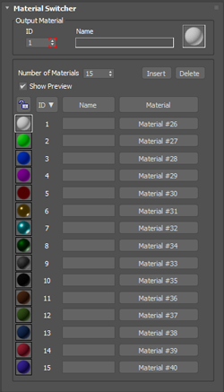

Interface
[material controls]
These buttons appear above the sort list controls. They are used to show information about the output material, control the amount of list items, and insert and delete materials.
Index Number (ID)
Displays the index number of the selected material.
Name Field
This field displays the user-defined name of the selected output material.
Number of Materials
Click to control the number of materials available in the list.
Insert
Click to insert a new entry into the list. The entry inserted will appear above the selected material in the material switcher, the entry will be empty until you select a material to occupy it. If the selection is locked, the inserted item will appear above where the secondary selection is made. The secondary selection is identified with the blue square.
Delete
Click to delete the selected entry from the list. Deleting a material from Material Switcher will delete it's connection to Material Switcher (it will not delete the material itself).
[sort list controls]
These buttons appear above four of the columns in the sub-materials list. They are used to organize materials.
Lock Header
Click to toggle the ability to switch materials by selecting material icons.
ID Header
Click to set the output material to the index (ID) number shown (descending or ascending).
Name Header
Click to sort the materials by user-defined names.
Material Header
Click to sort the materials by material type.
[list of materials]
Each material has a single entry in this list. The rollout can display 9999 materials, you can scroll the list using the scrollbar at the right.
Each material in the list has the following controls:
Small sample sphere
The small sample sphere is a "mini-preview" of the material. Click it to select this material. You must select a material before you delete it.
ID
Shows the index number assigned to this material.
Name
Lets you enter a custom name for the material.
Material/None button
By default, each list item will be set to None, indicating you can add a new material to the list from the Material/Map browser.
Once you have entered a material into the list, its name will appear here. Click the material to view or edit its attributes.
