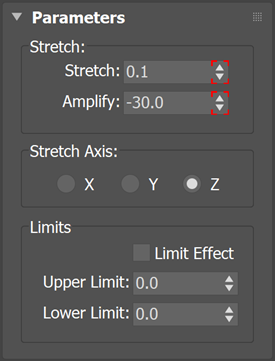

- Drag the time slider to frame 6.
- On the Parameters rollout for the Stretch modifier, change the Stretch value to
0.1.
The Stretch field’s spinner arrows now show red brackets, indicating that 3ds Max has created an animation key for this parameter. In the viewports, you can see that the basketball is elongated along its direction of travel.

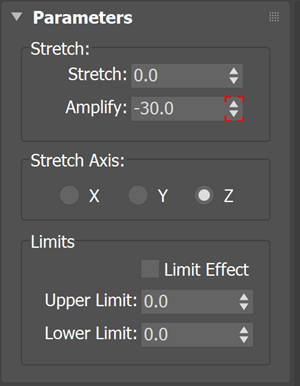

- Drag the time slider to frame 30, and change the Stretch value back to
0.0.
Tip: Just right-click the spinner arrows to set the value back to zero. In 3ds Max, this is a standard shortcut for setting a numeric field to its minimum nonnegative value.

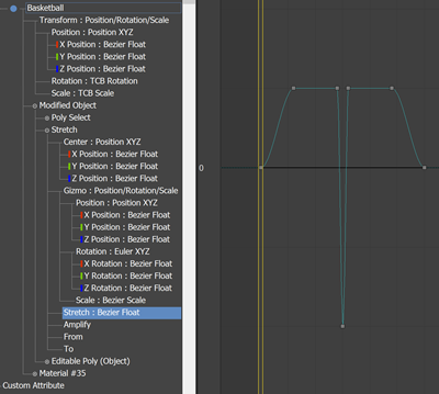

Repeat the stretch and squash:
- In the Curve Editor
controller window, locate the track for the Stretch parameter.
The hierarchy looks like Basketball
Modified Object
Stretch
Stretch : Bezier Float. You have to scroll down to get past several position, rotation, and scale tracks that you arent using in this exercise.

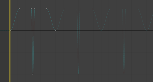

- On the Track View - Curve Editor toolbar, click
(Parameter Curve Out-Of-Range Types).
- In the Param Curve Out-Of-Range Types dialog, click the outgoing button for the Cycle option, and then click OK.
Now the squash and stretch pattern repeats indefinitely.
