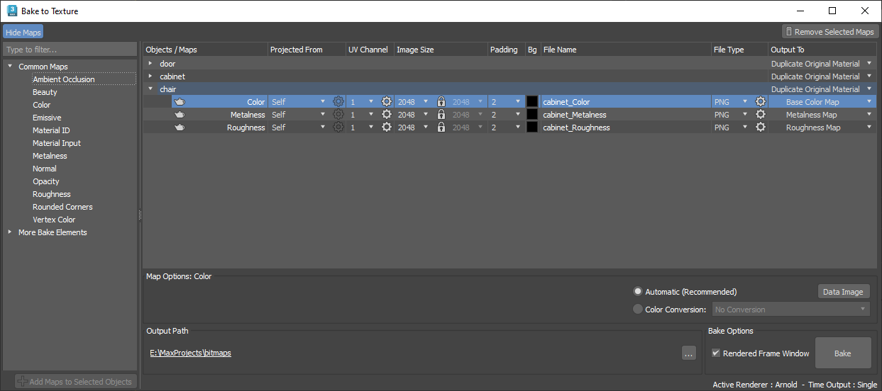

Interface
Show/Hide Maps (top left)
Shows or hides the list of available maps, shown in a pane at the left of the window.
Remove Selected Maps (top right)
Removes the selected map(s) from the queue.
Type to Filter field
Enter characters to filter the available map list.
Map list
Shows the list of maps available for selection. Use Ctrl and Shift to select multiple maps. The list of maps is organized by installed renderers with baking elements.
Add Maps to Selected Objects (bottom left)
Adds selected maps to the currently-selected objects in the scene or the baking list.
Note: The button is disabled when no object or no map is currently selected.
Baking List
The Baking list shows all currently-added objects and their associated maps along with their various controls for output. You can select multiple items at once using Ctrl and Shift, or double-click on the object's name to select all the maps of this object. Once you have multiple items selected, if you update a setting in a column, all selected items will be updated.
Object/Maps
Shows the selected objects and the maps to be outputted. Click the icon to disable baking a map. The icon shows a previously-disabled map while the icon shows that the selected map is not renderable with the currently active renderer.
Projected From
Selects the object to be used to render the map. For example, a higher-resolution object can be selected whose surface properties such as normals, displacement or another map will then be used. This operation automatically applies a Projection modifier to the object if one was not added before launching Bake To Texture. See the Projection Modifier topic (link at bottom) for more information.
  • Self: uses the map's parent object to render
  • Projection: uses the reference geometry defined by the selected projection modifier to render
  • Pick from Scene:lets you pick a single object in the viewport to automatically create a projection setup using the object as the reference geometry
  • Pick from List: lets you pick multiple objects from the scene's object list to automatically create a projection setup using the objects as reference geometry.
Click to open the Projection Options dialog (see section below) where you can select the projection method and adjust options for ray hits and misses.
UV Channel
Sets the UV Channel used for baking the map.
Click to open the Configure UV Channel dialog where you can set options for baking multi-tile UVs using either UDIM, MudBox, or ZBrush patterns.
Image Size
Sets the width and height of the baked image. To change the image size to a non-square ratio, click the icon to unlock and select new values from the drop down lists.
Padding
Sets the amount in pixels are allowed to bleed past the edges in the flattened (unwrapped) texture. Increase the value if the baked texture shows visible seams in shaded viewports and/or renderings.
Bg
Click to set a custom background color for the output file. If a background color is not applicable to the file, a gray square is shown.
Note: If the selected file type has an alpha channel enabled, the resulting background will be transparent and no color will be used.
File Name
Shows the name of the file to be output. Click the field to input a custom file name.
File Type
Shows the type of the file to be output. You can select another image file format from the drop-down list or click the icon to view options for the file type.
Output To
Sets the destination of the baked maps. You can either simply save the resulting files or prepare them so they can also be viewed in the scene. To be viewed in a scene, the baked maps need to be assigned to the given object's material.
The options at the object level are:
  • Files Only: bakes to files only. If you choose Files Only at the object level, all maps for this object will be rendered as files only.
  • Original material: the output is connected to the original material. Since baked bitmaps are connected directly to the material currently on the object, this is a destructive workflow
  • Duplicate Original material: keeps the original material of the object for a non-destructive workflow. To do this, a Shell material is assigned to the object, with inputs for both the baked and original materials. The original material and the baked material are of the same type (for example, Physical or Standard (legacy)).
  • Create new material: opens the Material browser where you can choose a material type. When baked, a material of the selected type will be created and connected to a Shell material as the baked material. The baked maps can be connected to this new material. This workflow is also non-destructive.
Note: If you have not assigned a material to your object, only the File Only and Create New Material options will be shown.
The options at the map level are:
  • File Only: bakes to file only. The baked map is not assigned to any material input.
  • Material Input: bakes to one of the inputs of your material (either a duplicate of the original, the original, or a new material). Only one map can be connected to a material input at a time. Once a material input is used by a map, this input is no longer available for other maps and will be grayed out.
When baking multiple UV files and choosing to output to a material, a MultiTile map will be created referencing the resulting image tiles.
When baking an animated map and choosing to output to a material, a Bitmap map will be created referencing the resulting Image File Sequence (IFL).
Map Options
Shows the options for baking the selected map, if available. Most settings are self-explanatory however some useful map options include:
Color
[OCIO color management modes only]
Controls how colors are converted from the rendering space when saving output files.
Automatic (Recommended)
Applies the output color transforms specified in the Color Management Settings dialog box. When Automatic is on, the transforms that will be applied are shown read-only under Color Conversion.
For image file lists (IFL), Automatic applies the transform determined by the settings to each file individually. If you instead specify a Color Conversion manually, that transform gets applied to all images in the list.
Color Conversion
Specifies the type of transform to apply to rendered output files. Extra options may appear depending on your selection.
  • No Conversion: Saves the untransformed rendering-space values. This is the best choice if the images will be processed further, because the full dynamic range is available for operations like compositing and grading.
  • Color Space Conversion: Lets you select a transform from the Color Space drop-down to convert colors from the rendering space to another one. For example, you can match the color space of specific files such as those from a digital camera if that space is available in the config file.
  • Display / View Transform: Lets you apply any available combination of Display and View transforms to rendered images.
Color Space
When Color Conversion is set to Color Space Conversion, select a color space for rendered files. The list of choices depends on the config file. With 3ds Max's default config file, you can select any space that is supported for image inputs.
Display
When Color Conversion is set to Display / View Transform, select a display to encode rendered images for. The list of choices depends on the displays available in the config file.
View Transform
When Color Conversion is set to Display / View Transform, select a tone map. The list of choices depends on the view transforms available in the config file.
Data Image
Sets Color Conversion to Color Space Conversion and Color Space to Raw. Use this when rendering files that contain non-color data such as normals, motion vectors, and so on.
Gamma [Gamma Workflow color management mode only]
Specifies how to handle gamma for the output file.
Automatic
Automatically determines the gamma based on the output format's bit depth. Low-dynamic-range images (8- or 16-bit) are assumed to have the standard sRGB gamma of 2.2, and high-dynamic-range (floating-point or logarithmic) images are assumed to use a gamma of 1.0 (no correction).
For most scenes, you should leave the gamma-handling set to Automatic.
Override
Uses the value you specify for the gamma.
Normals
Normal Map Space
Sets the coordinate system to be used for normals: either World, Screen, Object (local), or Tangent space.
Sync With
Syncs normal display based on a specific software you want to export to or a custom setting.
X (Red)
Sets the X normals to either left or right.
Y (Green)
Sets the Y normals to either up or down.
MikkT for Tangent (Tangent space only)
When enabled, uses the MikkT algorithm to calculate tangent space. This setting can help correct unsightly hard edges when an object is shaded.
Note: For MikkT to be displayed correctly in the viewport, you must also set the option under Customize > Preferences > General > Normal Bump Mode.
Calculate bitangent per pixel (Tangent space only)
When enabled, calculates bitangents per pixel rather than per vertex. Some applications such as Unity have this option disabled however if you are having display issues in other applications, try enabling or disabling this option.
Note: For this mode to be displayed correctly in the viewport, you must also set the option under Customize > Preferences > General > Normal Bump Mode.
Output into Normal Bump
Generate a normal bump node to connect the normal map to the material's input.
Output Path
Shows the current output path for baking maps. To change the path, click ... to the right to choose another folder.
Override/Arnold_map_override
This map is useful for creating a material ID, blended box map, vertex color, OSL map, or any other map that is not part of the object's material. You can create as many Override maps as you need for any given object.
Bake Options group
Rendered Frame Window
Enable to display the results in a rendered frame window as each individual file is baked.
Bake
Starts the baking operation using the currently-defined outputs and settings.
The Baking Progress dialog opens, showing the current status of each file in the queue. You can click Cancel to stop the operations in progress or click Close to close the dialog when baking is completed. You can also enable the option to automatically close the dialog when done.
If there are existing files found, you will be prompted to overwrite the files.
In the Rendered Frame window, the current progress of the full RGBA bake will be shown. Click RGBA to select another baking map to view from the drop-down menu. Once a map is finished baking, you can click a link in the Baking Progress window to display the final result.

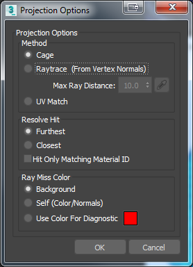

Method group
Cage
Uses a cage for the projection. Cages are a non-renderable type of sub-object used as surfaces for projecting normals. A cage duplicates the position and shape of the low-resolution object. For more information, see the Projection Modifier topic (link at bottom).
Raytrace (From Vertex Normals)
When enabled, ray-traces normals between the source and target objects. To do this, the objects must be perfectly aligned in world space. When you view both high-resolution and low-resolution objects in the viewports, they must line up with each other exactly. There are no special requirements for the mapping coordinates of the high-resolution objects.
Max Ray Distance
Sets the maximum distance for raytracing. Any parts of the surface beyond the value are considered as missed when raytraced. Use the spinner to set the desired distance.
You can also the eyedropper to pick the maximum distance by picking and dragging in a viewport. With the button enabled, click at the desired height. The maximum value is updated based on your selection.
UV Match
When enabled, normals are calculated by matching the target object's local UV coordinates to those of the source. To do this, the UV coordinates for the objects must be perfectly aligned. If you look at the objects using the Edit UVWs dialog of the Unwrap UVW modifier, the low-res and high-res objects must be lined up exactly. The high-resolution object must also have mapping coordinates on the same map channel used for the low-resolution object.
Typically, the high-resolution object will have an Unwrap UVW modifier assigned, but this is not required.
When using this option, the high-resolution object does not need to be in the same physical location as the low-resolution object.
Resolve Hit group
These options are useful with scenes containing semi-transparent objects, where more than one hit can occur for each ray.
Furthest
Uses the closest object in the case of multiple hits.
Closest
Hit Only Matching Material ID
When enabled, the projection occurs only between material IDs that match. This option enables a single map to contain normal bump projections from different high-res source geometry.
Ray Miss Color group
Sets what to bake if the projection method doesn't find any surface to bake from the reference geometry.
Background
Bakes the background color set in the Bake To texture window.
Self (Color/Normals)
Uses the map's parent object as reference geometry for the map to bake.
Use Color For Diagnostic
Bakes the selected color. This is useful for differentiating trouble areas from the background color of the map. Click the color picker to select another color.
