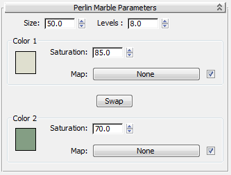

Interface
Size
Sets the size of the marble pattern. Change this to change the scale of marble, relative to the object's geometry. Default=50.
Levels
Sets the number of times the turbulence algorithm is applied. Can range from 1.0 to 10.0. The higher the value, the more complicated the marble pattern. Default=8.0.
Color 1 and Color 2 groups
The controls in these groups are identical. They determine the two main colors of the marble.
[color swatch]
Click to display the Color Selector. and change the color.
Saturation
Controls the saturation of the color in the map, without altering the color displayed in the color swatch. Lower values darken the color, and higher values lighten it. Range=1 to 100; Default=85 for Color 1, 70 for Color 2.
Map button
Click to assign a map instead of a solid color. The checkbox turns the map on or off.
Swap
Click to swap Color 1 and Color 2.
