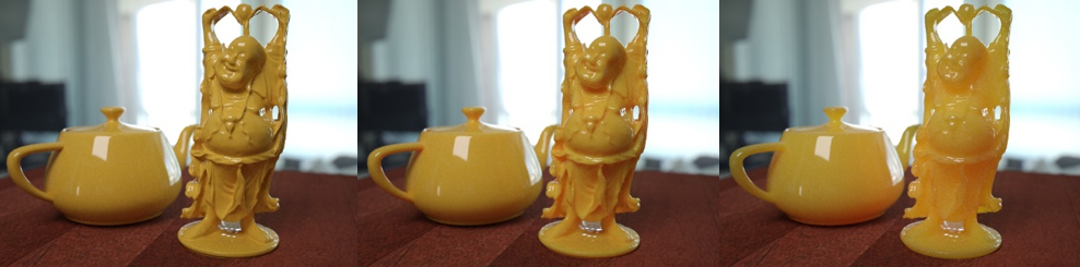

When Metalness is 0.0, you see a colored base layer with a generally white reflection on top. Note how the reflective intensity is perceived to be weaker as roughness goes up, because light energy is spread wider.
Metalness=0.0 and Roughness=0.0, 0.3, and 0.6 respectively

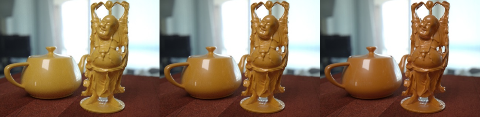

When Metalness is 1.0, you do not see the base layer, just the colored reflection. The reflection color comes from the base color and base weight, except on edges where it comes from the reflection color (generally white).
Metalness=1.0 and Roughness=0.0, 0.3, and 0.6 respectively

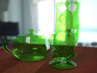

The Depth parameter enables absorption into the material. If the depth is 0.0, a traditional computer graphics model of transparency is used, where light becomes colored at the surface and is not effected by travelling inside the medium. Therefore the object's thickness has no affect.
Depth=0.0

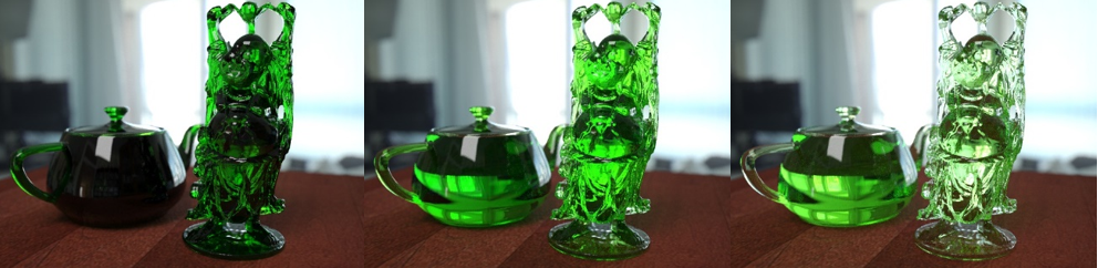

However, if the depth is not 0.0, the light will be effected by absorption in the medium in such a way that at the designated depth light will have the given color.
Depth=0.1cm, 1.0cm, and 5.0cm respectively

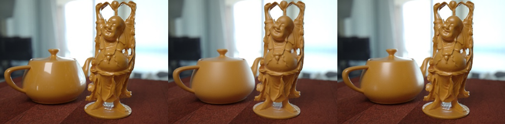

The Depth parameter defines how deeply light penetrates into the object. Scale is a pure linear scale to depth that can be texture-mapped, allowing the scale to change across the object. When the depth is 0.0, the shading is effectively identical to pure diffuse shading. The higher the depth, the more light penetrates the object.
SSS Depth=0.0, 0.1, and 1.0 respectively

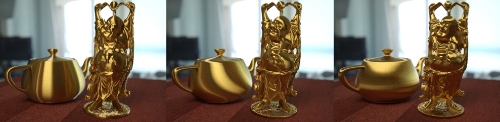

Anisotropy is an effect seen in materials such as brushed metal, where a particular grain direction gives the visual effect of having a different surface roughness in different directions. Highlights and reflections appear "stretched" in a particular direction.
The Anisotropy parameter defines how "stretchy" the effect is. In principle, it is the ratio between the horizontal and vertical roughness values. A value of 1.0 represents maximum anisotropy.
Anisotropy=0.1, 0.5, and 1.0 respectively
The anisotropy effect can be rotated using the Rotation parameter, where 0.0 to 1.0 is a full 360 degree rotation.
Rotation=0.0, 0.12, and 0.25 respectively

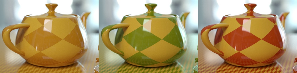

The coating itself can also have a color. This is the color of the coating layer's transparency. In the following example, a diamond shaped map has been applied to the Coating Weight and different Coating Colors used.
Coating Color=white, green, and red respectively
In the example on the left, the coating is only changed by the darkening effect of the Affect Underlying Color parameter, whereas the examples on the right are further affected because they are being seen through the coating color itself. This is similar to painting the object in a semi-transparent layer of paint or laquer.

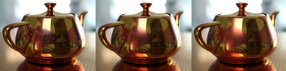

The coating also has an Affect Underlying Roughness parameter. This causes the coating's roughness to have an effect on the underlying layer's roughness, simulating the blurring effect of being seen through the top layer.
In the following example, a red tinted coating has been used on top of a base color with Metalness set to 1.0.
Affect Roughness=0.0, 0.5, and 1.0 respectively
In the example on the left, the metal covered by the red coating is unaffected, whereas the examples on the right yield a blurred appearance.

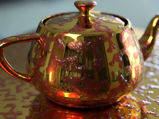

The Coating parameter also has a separate bump map. This allows you to generate some interesting effects using the coating layer, such as a brass teapot covered in jam.
