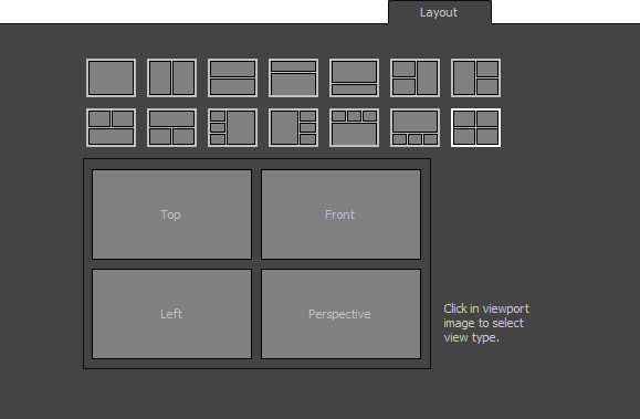

You specify the division method of viewports, and assign specific types of views to each viewport on the Layout panel of the Viewport Configuration dialog.
  • Click or right-click the General viewport label (“[ + ]”) . > General Viewport Label Menu > Configure > Viewport Configuration dialog > Viewport Layout panel
  • Default menu: Views menu > Viewport Configuration > Viewport Configuration dialog > Layout panel

The Layout panel is arranged in two general areas. At the top are icons representing the possible division methods. Below these is a screen representation of the currently selected layout. Click an icon to select the division method, which appears in the larger screen representation.
To assign specific views, click or right-click a viewport in the larger screen representation. Choose a viewport type from the menu that appears.
