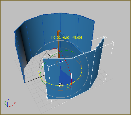

Rotate the right enclosure:
  1. Select the right enclosure panels object.

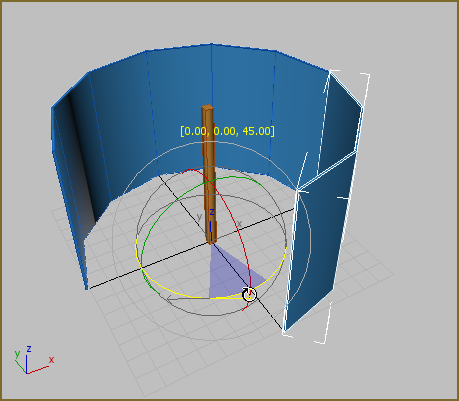

  2. On the main toolbar, click to activate (Select And Rotate), and then move your mouse over the Transform gizmo tripod in the viewport. When the Z axis (the blue horizontal circle) is highlighted, click and drag to rotate the right enclosure panels object 45 degrees about the Z axis until it touches the left enclosure panels object, as shown below.
    As you rotate, you can see the rotation amount in yellow text in the viewport, just over the transform gizmo. To get the desired result, it should read (0.00, 0.00, 45.00).
    Rotate the right enclosure.
    This rotation is temporary, for the purpose of modeling only.

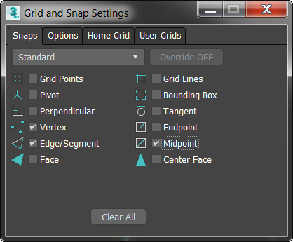

  1. Right-click any of the Snap buttons on the main toolbar, or from the menu bar choose Tools Grids And Snaps Grid And Snap Settings.
    3ds Max opens the Grids And Snap Settings dialog.
  2. On the Snaps panel, click Clear All, then turn on Vertex, Edge/Segment, and Midpoint. Close the dialog.
    Note: Even though you've changed the snap settings, you still need to turn on snapping.
  3. Press S to turn on snapping.
    On the main toolbar, the 3D Snap button highlights.

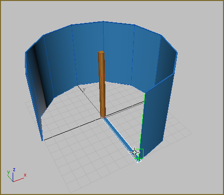

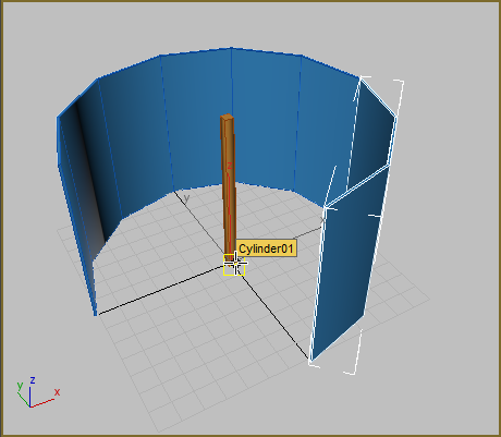

  5. In the Perspective viewport, move your cursor over the cylinder in the center.
    You can see the snap icon that follows the edges of the cylinder as you move.
  6. Position your cursor so you are snapping to the bottom-right edge of the cylinder.
  7. Drag to the right, away from the cylinder, keeping the mouse button depressed. Snap to the front of the right enclosure object. Release the mouse button to set the width of the door.
    Snap to the right enclosure.
  8. Press S to turn snaps off.
  9. Without moving the mouse, click once to set the depth of the door frame (the default value: 0' 0"), and then move the mouse upward to adjust the height of the door. Click to set the height. Don't be precise about the height: You'll correct this in the next procedure .

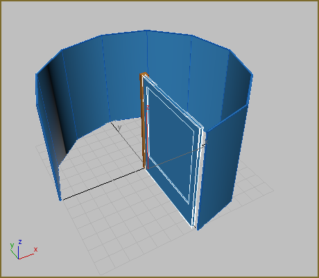

Adjust the door parameters:
    Immediately after clicking to set the height, make the following parameter adjustments, watching the effects in the viewport. You can adjust these parameters at any time in the future using the Modify panel.
  1. In the Frame group, turn off Create Frame.
    The frame disappears from the door.
  2. On the Leaf Parameters rollout, increase the Stiles/Top Rail value to 0' 5.0”.
  3. Set the Bottom Rail parameter to 1' 6.0".
  4. Going back up to the main door parameters, change the Width of the door to 5' 5.0" so it fits inside the enclosure. Change the Height of the door to 7' 0.0". You may want to adjust the Depth as well, but make sure the door is narrower than the side of the cylinder.

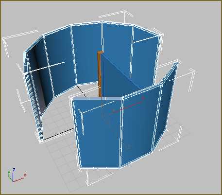

Rotate the enclosure:
  1. Select the right enclosure panels object: the one you rotated earlier in this lesson.
  2. Rotate the sliced tube back into place; that is, –45 degrees on the Z axis.
    Tip: If you prefer, you can enter the rotation in the coordinate display on the status bar.
    Note: If the pivot door sticks through the enclosure after you rotate it, select the pivot door and on the Modify panel, reduce its width so it fits within the space properly.
