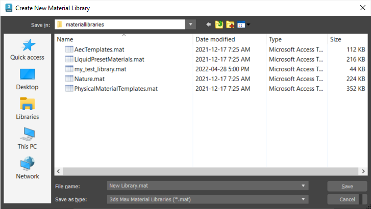

To create a new library:
  • In Material/Map Browser, open the Options menu and choose New Material Library.
    3ds Max prompts you for a name for the new library.
    The new library appears in the Material/Map Browser.
    3ds Max saves the library as a MAT file with the name you entered; for example, New Library.mat. The default location for the library is the \materiallibraries folder in your current project. If you have not set a project folder, it saves the new library in the folder <3ds Max program folder>\materiallibraries.
