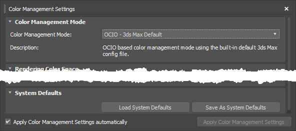

You first select a Color Management Mode and then set options for the selected mode. The color management settings are saved with each scene, and the saved settings are used when each scene is re-opened.
  • Click Save As System Settings to use the current settings as the default for new scenes.
  • Click Load System Defaults to restore the last-saved system settings.
The mode controls which color management system to use for the scene, and the dialog box updates to reflect the settings that are available for each mode. For information about the principles of color management and the differences between the modes, see Color Management.

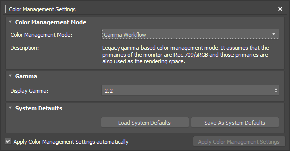

Gamma Workflow
The legacy gamma-based color management mode. Colors are treated in the same way as in versions of 3ds Max prior to 2024. Gamma encoding is removed from color inputs, and then re-applied for display and output after the lighting calculations have been performed. This mode assumes that the primaries of the monitor are Rec.709/sRGB and those primaries are also used for rendering. See "Gamma Workflow options" below.
OCIO - 3ds Max Default
OpenColorIO-based color management using 3ds Max's built-in configuration file. This configuration is based on ACES, the Academy Color Encoding System. It offers a choice of color spaces and transforms that are suitable for a modern pipeline. See "OCIO options" below.

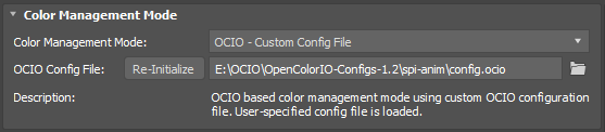

OCIO - Custom Config File
Similar to OCIO - 3ds Max Default but with the option to specify a custom configuration file, such as one that has been especially developed for your project or studio. See "OCIO options" below.
OCIO - Environment Variable
Uses the configuration file specified by the OCIO environment variable. This is an environment variable that can be set to the path and name of a configuration file to be used by various OCIO-enabled applications in order to ensure consistency across a content pipeline. See "OCIO options" below.
Note: If the OCIO environment variable has not been set to the full path of a valid OCIO config file on your system, the Description includes the message "No config file is loaded..." and colors will not be managed.

OCIO Config File
Specifies the absolute path and name of an OCIO configuration file (.ocio) or archive file (.ocioz) that defines the available color spaces, transforms, and other options. This file must be available on all machines that are used to edit and render the scene.
With OCIO - Environment Variable, this text box displays the resolved path of the OCIO environment variable and cannot be edited.
Note: If there are any issues loading the specified config file, messages appear on the Color Management tab of the Render Message Window.
Re-Initialize
Updates the spaces and transforms in memory from the config file on disk. Click this button, for example, if you have a config file that uses context variables like $shot that have been changed or if the config file has been changed in any other way during the current session of 3ds Max.

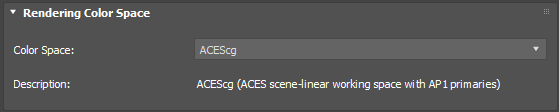

Rendering Color Space
Color Space
The color space in which shading calculations are performed. Color inputs are transformed into this space for rendering, and rendered images are transformed from this space for viewing.
The following rendering spaces are available in 3ds Max's default config file — all of them are scene-linear (that is, values are directly proportional to the amount of light energy in the scene), which is necessary to be compatible with modern renderers. If you are using a custom config, different spaces may be available.
  • ACEScg: ACES scene-linear working space using the AP1 primary chromaticities for red, green, and blue. This color space is part of the Academy Color Encoding System, and is designed to be appropriate for computer graphic operations like compositing and 3D rendering. It encompasses both the Rec-2020 gamut and the DCI-P3 gamut for a range of white points.
  • scene-linear Rec.709-sRGB: A working space that uses the same primaries as sRGB and HDTV (Rec. 709), but with scene-linear color values. This is a common rendering space but it has a very limited gamut, meaning that it can represent only a relatively small range of colors when compared to digital cinema or film. For this reason it is often desirable to use a rendering space with a wider gamut, especially when rendering 3D elements that will be composited together with footage from digital cameras or scanned film plates.
  • scene-linear DCI-P3 D65: A working space that uses the same primaries as a DCI/SMPTE "P3" reference projector, but with scene-linear color values and the D65 white point. The advantage of using this color space is that it can represent all the colors available on a modern projector. In addition, there is little risk of producing colors that are out-of-gamut for a projector, which might cause unpleasant surprises if the content is ever viewed in the future on a device with a wider gamut.
  • scene-linear Rec.2020: A working space that uses the same primaries as UHDTV and HDR TV, but with scene-linear color values. The standard for HDR TV is actually Rec.2100, but it uses the same primaries. This space can represent any color that is theoretically possible for UHDTV or HDR TV, but since the Rec.2020 primaries are on the spectral locus there are no actual displays that are able to accurately show the full gamut of colors.
Note: Any literal color values (including solid colors and other color parameters) in the scene are assumed to be in the rendering space, but they are not converted when you change the rendering space in a scene that has already been set up. This can result in final colors that were not intended, so it's best to set up color management at the start of a new scene or project.

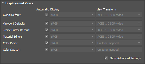

Displays and Views
Controls how the color values of the rendering space values appear in various windows and UI elements. Use Global Default to control all elements at once, or turn on Show Advanced Settings to set options for various elements individually.
You can control the following windows and UI elements independently:
  • Global Default: Controls any of the individual elements (available when Show Advanced Settings is on) that are set to Automatic. Note that Color Picker and Color Swatch have a different default for View Transform.
  • Viewport Default: The default settings for the viewports. You can change the settings for a specific viewport on the Color Management tab of the Active Viewport Settings dialog box available from the Shading viewport label menu. Note that the Color Management tab is available on the Active Viewport Settings dialog box only when using an OCIO color management mode.
  • Frame Buffer Default: The default settings for the Rendered Frame Window. You can change these on-the-fly on the Rendered Frame Window's toolbar.
  • Material Editor: The settings for thumbnails in the Material Editor.
  • Color Picker: The settings used by the Color Selector dialog box.
  • Color Swatch: The settings used by color swatches.
For each element, you can set the following controls:
Automatic
Uses the Global Default settings or in the case of Global Default itself, uses the default choices from the OCIO configuration file. Turn Automatic off to set Display and View options manually.
Display
Select the option that best matches the calibration state of your display. The choices available in 3ds Max's default config file are listed below. If you are using a custom config, your choices may be different.
  • sRGB: sRGB primaries and gamma.
  • Gamma 2.2/Rec. 709: Rec. 709/sRGB primaries and a gamma of 2.2.
  • Rec. 1886/Rec. 709: Rec. 709 video.
  • AdobeRGB: Adobe RGB (1998) color space.
  • DCI-P3 D65: digital cinema "P3" projector with an artistic white point of D65.
If you are using a custom config, select Display before selecting View Transform because the available views might depend on the display. This is not the case for 3ds Max's default config file, however.

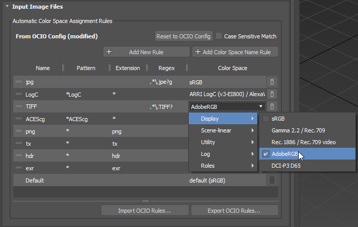

Input Image Files
Automatic Color Space Assignment Rules
The table shows the rules that automatically assign color spaces to input images based on file name and path. Image-based textures are converted from the assigned input space to the rendering space for shading calculations. Note that when you specify an image to use as a texture in a scene, you can always change the automatically-assigned color space if it is incorrect.
The initial rules are defined in the configuration file, but you can edit them here to match the color spaces and file-naming conventions that you typically use. For the full details, see To Edit Color-space Assignment Rules.
  • Double-click in a table cell to change a rule's name, file name pattern, extension, regex pattern, or the color space that it assigns. Note that a rule can be based either on a file's full path and extension using glob syntax, or using regular expressions (regex), but not both. If you modify Pattern or Extension, the Regex column gets cleared automatically and vice versa.
  • Click Add New Rule to add a row for a new rule at the top of the list.
  • Click Add Color Space Name Rule to add a special rule named ColorSpaceNamePathSearch which replicates how image files were assigned to color spaces in OCIO v1. It assigns each texture file to the longest color-space name found anywhere in its file path and name. Note that matches are not case-sensitive.
  • Drag one of the grippers at the left of a row to reorder the rules. The rules are tested in order from top to bottom. The first rule that matches a file is the rule that gets applied. Note that the Default rule cannot be moved and is always applied last if no other rule matches. In 3ds Max's default config, it assigns images to the color space that has the "default" role, which is sRGB in that config.
  • Click the trash-can icon at the right of a rule to delete it. You cannot delete the Default rule.
  • If the rules have been modified, the Reset to OCIO Config button appears. Click it if you want to restore the rules that are set in the selected config file.
Whenever the rules change, any existing textures whose color space was set to Automatic get re-assigned as appropriate. Textures whose color space was set manually do not change.

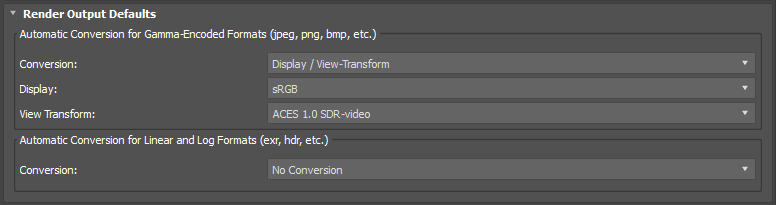

Render Output Defaults
Controls the color transform to be applied to rendered output files by default. At render time, you still have the option to select a different transform in the Render Output File dialog if you don't want to use the default that is set here.
  • Automatic Conversion for Gamma-Encoded Formats is the transform that is applied when Automatic is selected for JPEG, PNG, BMP, and other gamma-encoded image formats.
  • Automatic Conversion for Linear and Log Formats is the transform that is applied when Automatic is selected for linear and logarithmic image formats, including EXR and HDR.
Scenes saved in previous versions continue to work as before by default:
  • 3ds Max 2025 scenes use No Conversion when Automatic is selected for linear and logarithmic formats.
  • 3ds Max 2024 scenes always use the settings for gamma-encoded formats when Automatic is selected.
To change this behavior, modify the settings and save the scene with your current version before rendering.
Conversion
Specifies the type of transform to apply to rendered output files. Extra options may appear depending on your selection.
  • No Conversion: Saves the untransformed rendering-space values. This is the best choice if the images will be processed further, because the full dynamic range is available for operations like compositing and grading.
  • Color Space Conversion: Lets you select a transform from the Color Space drop-down to convert colors from the rendering space to another one. For example, you can match the color space of specific files such as those from a digital camera if that space is available in the config file.
  • Display / View Transform: Lets you apply any available combination of Display and View transforms to rendered images. When using 3ds Max's default config file:
    • For a photographic response on a standard monitor such as for an image posted on a web page, set Display to sRGB and View to ACES 1.0 SDR-video.
    • To emulate older workflows where colors above 1.0 are simply clipped, set Display to sRGB and View to Un-tone-mapped.
    • You can use other combinations for specific purposes, for example, to bake in a photographic tone map like ACES 1.0 SDR-video for a different display such as DCI-P3 D65.
There is only one option for the Gamma Workflow mode.
Note: LUTs are no longer supported (except through custom OCIO configurations).
Display Gamma
Enter the gamma value for compensating between display code values and display luminance. The default gamma of 2.2 closely approximates the sRGB gamma curve.
