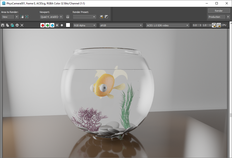

The Rendered Frame Window Title Bar
The title bar of the Rendered Frame Window includes this information:
  • Viewport name
  • Frame number
  • The display gamma value (when using Gamma Workflow color management mode) or view transform (when using an OCIO color management mode).
  • Image type and color depth
    For example, a full-color image with an alpha channel will show “RGBA Color 16 Bits/Channel”; a bitmap with a limited color depth might show “Indexed Color 8 Bits/Pixel,” and so on.
  • Image aspect ratio
Rendering Controls

Toggle UI Overlays
When on, displays the frame that shows the Region, Crop, or Blowup area when one of those options is active. To disable display of the frame, turn off this toggle.
Note: The frame is still active when not displayed.
Toggle UI
When on, all controls are available. When off, disables display of the rendering controls at the top of the dialog. To simplify the dialog interface and allow it to take up less space, turn this off.
Tip: When off, you can resize the window smaller than is possible when Toggle UI is on.
