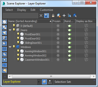

Objects are organized by layer in the dialog in a hierarchical list. By clicking
or
, you expand or collapse, respectively, the object list for each layer. To expand or collapse a layer and all of its child layers, hold the
Ctrl key while you click the arrow icon. To expand a layer and select it and its contents, double-click the layer name. To sort all layers on a specific property, click the column head of the property to sort on.
Another useful function is the ability to open the Object Properties dialog and Layer Properties dialog for one or more highlighted objects or layers directly from the Layer Explorer right-click menu.
Interface
The Layer Explorer interface and workflow are identical to that of Scene Explorer, with the exception of the methods detailed in the procedures in the topic To Work With Layer Explorer.
