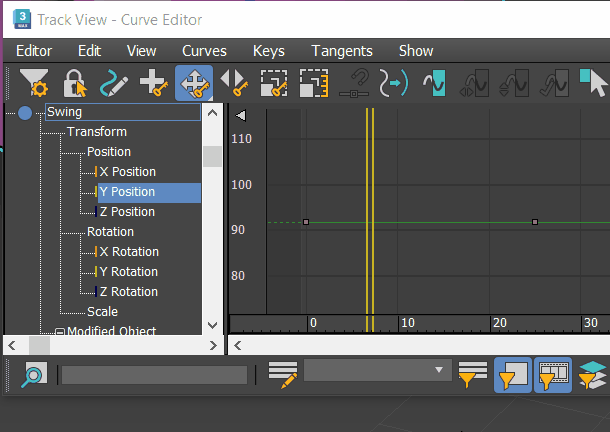

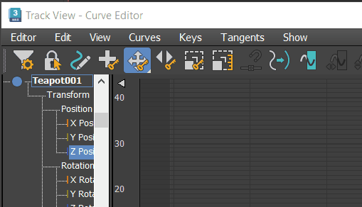

Assigning a controller in Track View
Example: To assign an animation controller in Track View:
  1. In the Track View Hierarchy, select one or more parameter items of the same type.
  2. From the Edit menu Controller submenu, choose Assign.

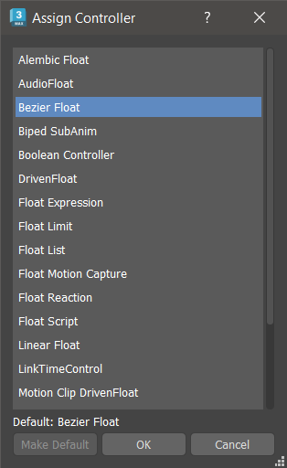

  3. Choose a controller type from the Assign Controller dialog. Depending on the type of track currently highlighted, the dialog lists a subset of the different types of controllers.
    Note: Do not confuse the Assign Controller dialog with the Assign Controller rollout. The Assign Controller rollout is in the Motion Panel and for managing transform controllers and the Assign Controller Dialog is the place where you choose and assign Animation Controllers.
