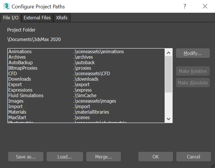

This panel contains most of the file directories used for storing files.
  • Default menu: Customize menu > Configure Project Paths > Configure Project Paths dialog > File I/O panel
  • Alt menu: Customize menu > Customization > Configure Project Paths > Configure Project Paths dialog > File I/O panel
Note: By default these paths are relative to the project folder. See the Project topic under File-Handling Commands for more information.

To modify a file path:
  1. On the Configure Project Paths dialog, click the File I/O panel, and choose a path entry.
  2. Click Modify.
  3. In the Choose Directory dialog, do one of the following:
    • Enter a path in the Path field.
    • Navigate to locate a path.
  4. Optional step: Enter a description of the path in the Label field.
    This description later appears in the path list.
  5. Click Use Path.
    The new path takes effect immediately.
