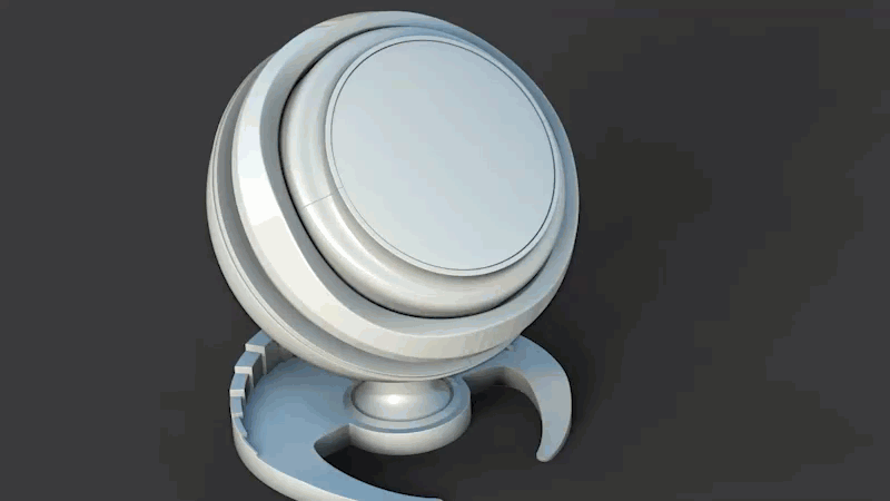

Slate Material Editor: Improved thumbnail cache
The Slate Material Editor thumbnail cache has been improved so that it holds unique thumbnails for different color management settings. This eliminates the unnecessary re-rendering of the thumbnails when, for example, the view-transform is changed back and forth.
In addition, the Update Browser Samples option in the Slate Material Editor preferences can be turned off to completely eliminate re-rendering the sample swatches in the Material/Map Browser when settings change. This can speed up interaction while working, but the swatches won't be accurate.
