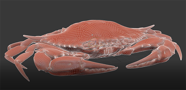

This topic addresses commonly-asked questions about working with the retopology tools. The Image below showcases a model with optimized retopology.

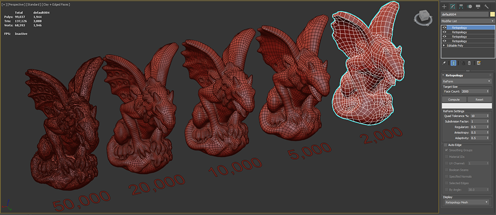

How do I target a specific polygon count?
- If want to reach a particular quad target count, try using multiple Retopology modifiers, using half the polygon (quad) count as the target. This will allow you to refine your shape while influencing what type of detail is retained instead of trying to achieve the quad target in one attempt.
- Because of how the retopology algorithms work, processing a mesh this way will be faster and faster with each use of the Retopology modifier because there will be less mesh data to process.
- Above is an example of multiple retopology modifiers processing a mesh (by half with each application) to reach a target goal of 2,000 quads.

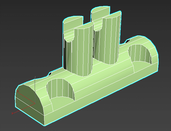

How do I use Retopology Tools accurately with Slice Modifier?
- Commonly, you can generate bad geometry data (degenerate faces) with the slice operation. For example, if you create a geosphere with a slice modifier and move the the slice gizmo to the middle of the mesh, then use Remove Negative and apply Retopology with ReForm after cutting with an axis, you can recieve a Cross-Field computation error. This error likely indicates degenerate faces in your geometry data. This can likely be resolved simply by applying the Mesh Cleaner modifier.
