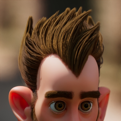

Hair melanin and redness: The
standard_hair
shader'smelanin
andmelanin_redness
parameters as well as theAidEonBSDF()
function'sabsorption
parameter are now being referenced in a linear sRGB color space so that the direct lighting results match when switching to other rendering color spaces such as ACEScg. Themelanin_redness

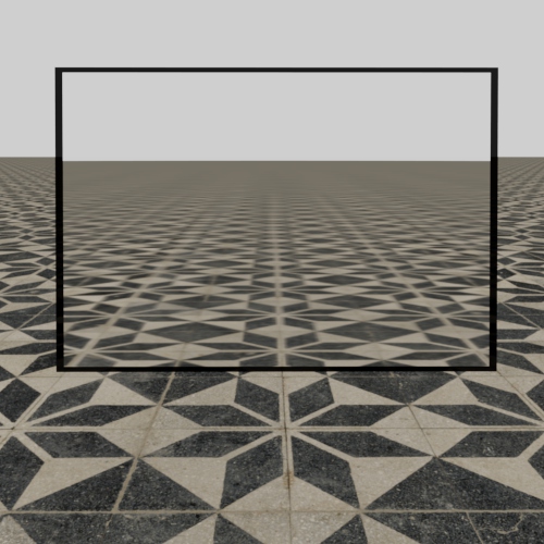

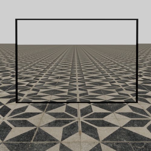

parameter will also now produce a more correct-looking red tint in ACEScg. (ARNOLD-7585).Arnold 7.1.3.2 Arnold 7.1.4.0 Sharp textures through reflections and refractions: Textures seen through specular reflections and refractions, particularly when there is low roughness, such as with clear windows and mirrors should now look correctly sharper. This can result in higher resolution texture mipmap levels being loaded in memory, so scenes that were affected by this can see an increase in texture cache usage. (ARNOLD-5632)
