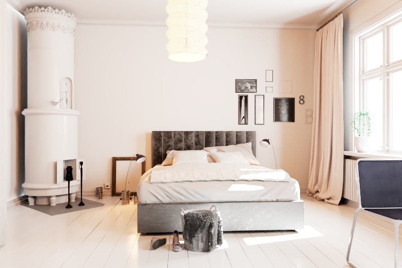

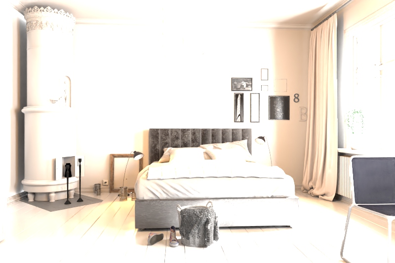

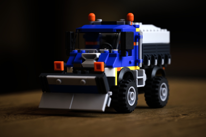

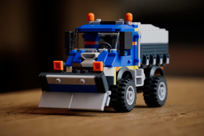

Support for 3ds Max 2024 Color Management: MAXtoA now passes on all color management information from 3ds Max to Arnold for rendering by handing over the entire OCIO configuration for rendering. (MAXTOA-1481).
without Color Management (default Gamma workflow) | with Color Management (ACES 1.0 SDR-video (sRGB) |

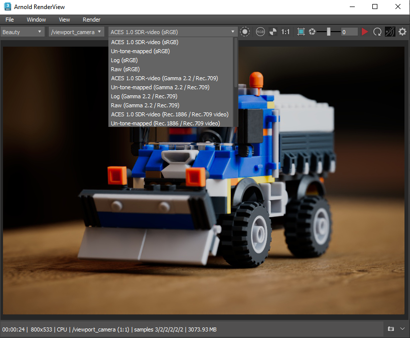

- Arnold Render View supports Max 2024 Color Management: Arnold Render View now shows menus for the view transform, plus obeys and automatically updates itself to any changes in 3ds Max Color Management settings. (MAXTOA-1502)
View Transform menu set to ACES 1.0 SDR-video (sRGB). Color Management enabled in Preferences.

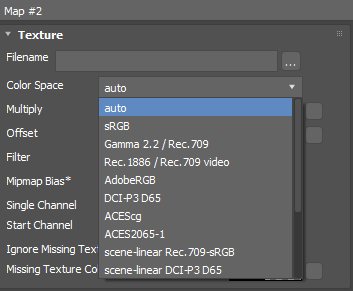

Arnold Image Node supports more color spaces: In earlier versions the Image node was limited to "auto", "linear", "sRGB" and "ACESCg" color spaces, and it was stored as an integer parameter with values from 0 to 3. This is now changed to a string parameter, and the provided choices are the color spaces defined in the OCIO configuration. When loading old files, the old integer value is automatically upgraded to its matching string value. (MAXTOA-1519)
Color Space options in image shader
