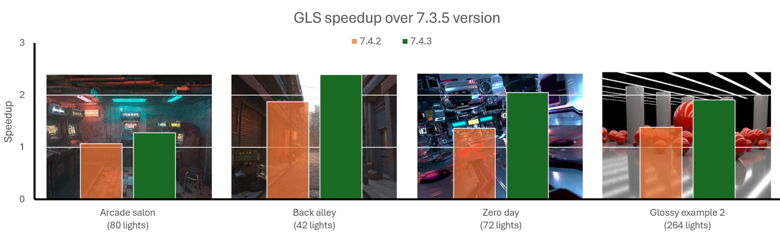

Faster rendering with Global Light Sampling: Scenes using Global Light Sampling, render up to 2.5x faster in our tests. The numbers below are for same-noise renders. (ARNOLD-13091)
- Improved Global Light Sampling (GLS) on glossy material in GPU renders: GPU renders (like CPU renders since Arnold 7.3.7.0) now take material glossiness into account when sampling, which greatly enhances the quality especially when many small lights are present. In the robot scene below, we get a ~3x speedup with adaptive rendering. (ARNOLD-15833)
| 7.4.2, fixed AA | 7.4.3, fixed AA, GLS glossy enabled |

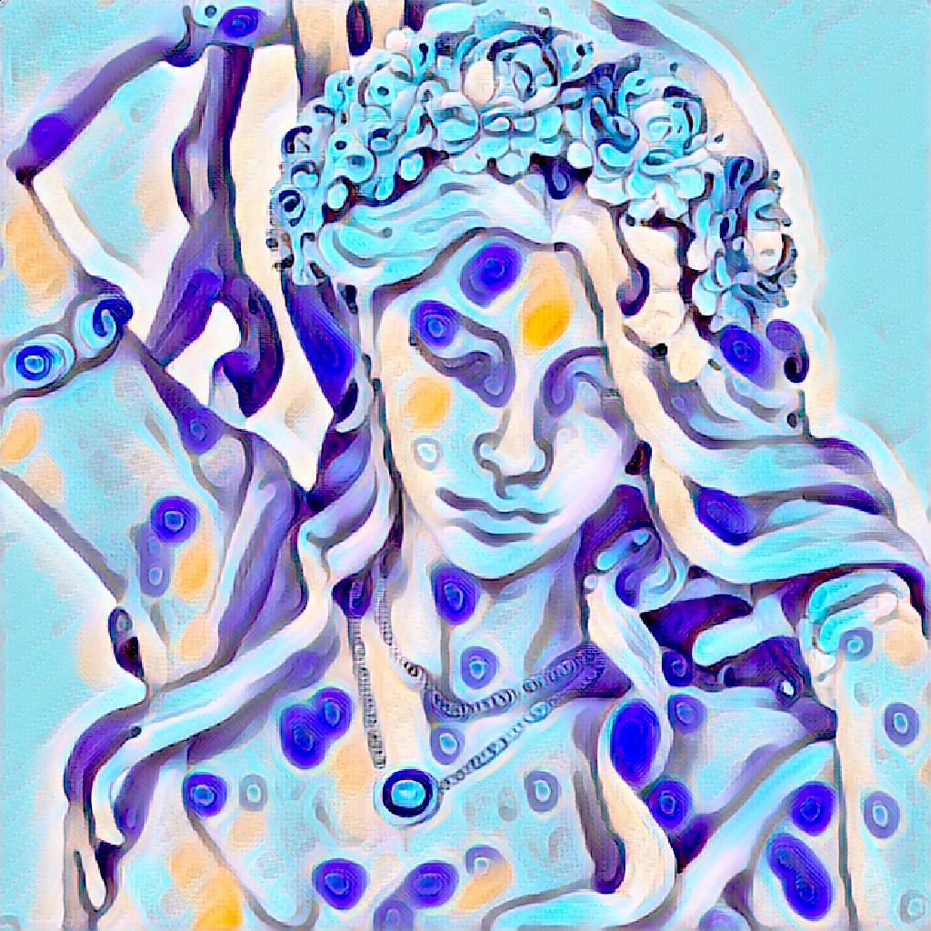

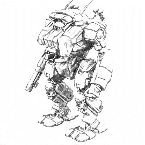

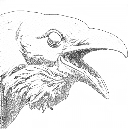

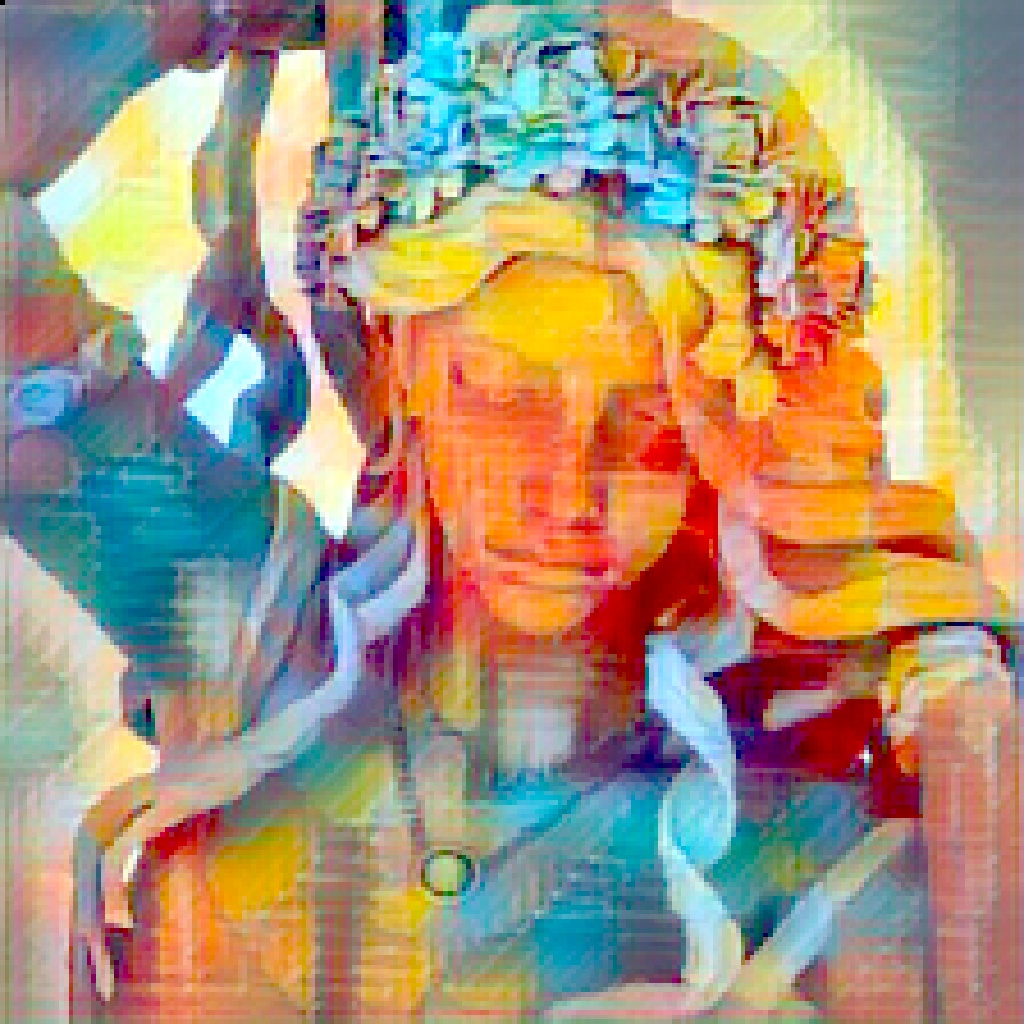

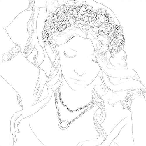

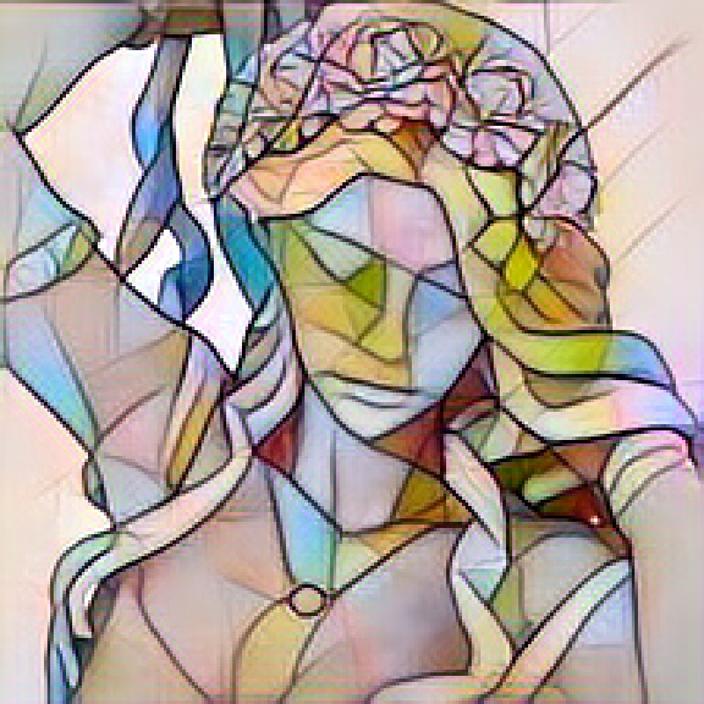

- Inference Imager: The Inference imager is capable of performing inference on image-to-image machine learning models using the ONNX framework. (ARNOLD-16071)

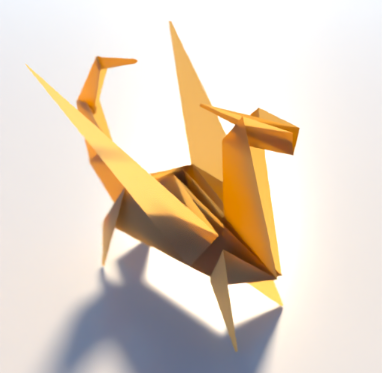

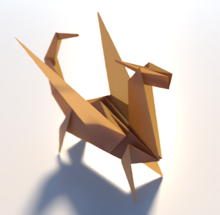

- Improved thin-walled subsurface in OpenPBR: The OpenPBR subsurface lobe in the thin-walled mode uses
subsurface_weightto blend between diffuse and subsurface lobes while maintaining energy conservation. You can use this, for example, to model diffuse transmission and reflection in paper. (ARNOLD-15982)
| previous behavior | ![]() |
| 7.4.3 | ![]() |
| 0 | 0.01 | 0.5 | 1 |

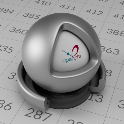

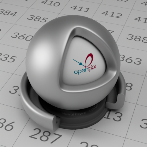

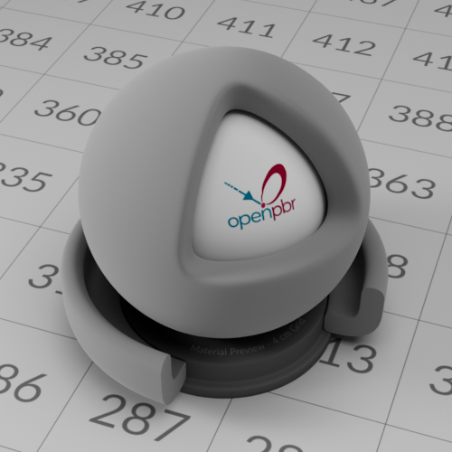

- Energy conserving metal in OpenPBR: The OpenPBR metal lobe now conserves energy and passes the furnace test. (ARNOLD-16327)
| 7.4.3 | ![]() |
| 0.25 | 0.5 | 1 |
