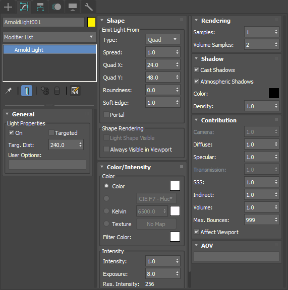

Common Light parameters
As well as honoring the standard 3ds Max light parameters, the Modify Panel will also show the following Arnold parameters:

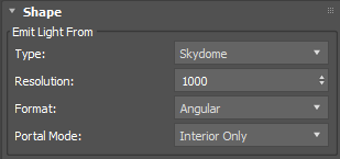

Shape
Type
The shape of the light. Choose from point, distant, spot, quad, disk, cylinder, skydome, photometric, and mesh.
Types of lights available in MAXtoA
Light Shape Visible
When enabled, the shape of the light is visible in the render as a self-illuminated object.
Contribution
Per-light scaling for camera, transmission, diffuse, specular, sss, indirect, and volume. Weights scaling the light contribution to each of those components independently. Should be left at 1 to produce physically accurate results.

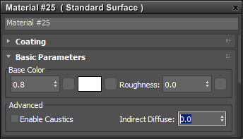

It is not currently possible to make a mesh_light visible to camera rays. A workaround is to add emission to a standard_surface shader assigned to the object. This will give the impression that the geometry is incandescent. Set the indirect_diffuse to 0 for the standard_surface shader assigned to mesh as the mesh_light is already emitting light.
Setting indirect_diffuse to 0 disables GI bounces for the mesh.

Quad Light

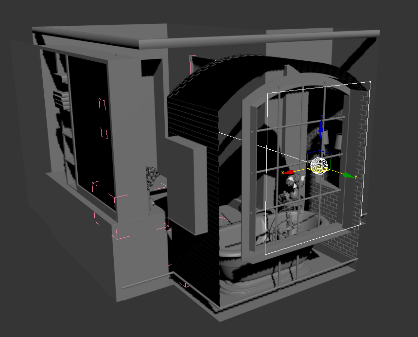

Simulates light from an area source (a quadrilateral, specified by four vertices). It can be used to model light from an extended source (fluorescent strip lights) or in some circumstances from a window.
The light portal should be oriented so that it is pointing in through the window as indicated below:
Light portal pointing inwards outside window

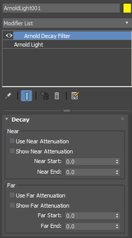

Modifiers give you the ability to copy and paste your light filter onto other lights, including instancing the modifiers to multiple lights. You can apply modifiers to Group objects containing lights by using Copy and Paste from a single light onto the Group object. The modifier is then instanced to all lights in the group, and controllable from the top-level group object. The four built-in light filters are included as separate modifiers: decay, barndoor, light_blocker, and gobo (also known as Projection). The fifth option, the 'Arnold Light Filter' modifier, allows you to place a custom light filter shader into the modifier:
Arnold decay filter Modifier added to Arnold Light

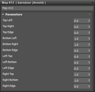

Barndoor
This light filter can only be used with spot lights. Barn doors are opaque moving panels attached to the sides of the light's opening. They are typically used in theatrical and film lighting for additional control over the shape of the light beam.
The barndoor filter's parameters

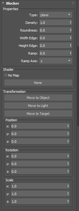

Blocker
Light blockers give flexibility to the lighting TD. They can be used as an artificial method of masking light in a scene without the overhead of adding additional geometry. Used carefully, they provide a degree of artistic freedom, allowing you to define the light boundaries in non-physical ways.
Decay
This filter can be added to all Arnold lights. This is where you will specify the attenuation ranges. All lights in Arnold use a physically-based falloff by default, but the light_decay filter can be used to adjust the falloff for artistic purposes.

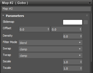

Gobo
The gobo filter can only be used with spot lights. In theatrical stage lighting, a gobo (or "cookie," slang for Cucoloris ) is a thin sheet of metal with holes used to break up the light beam into an irregular, more natural pattern such as tree leaves, etc.
