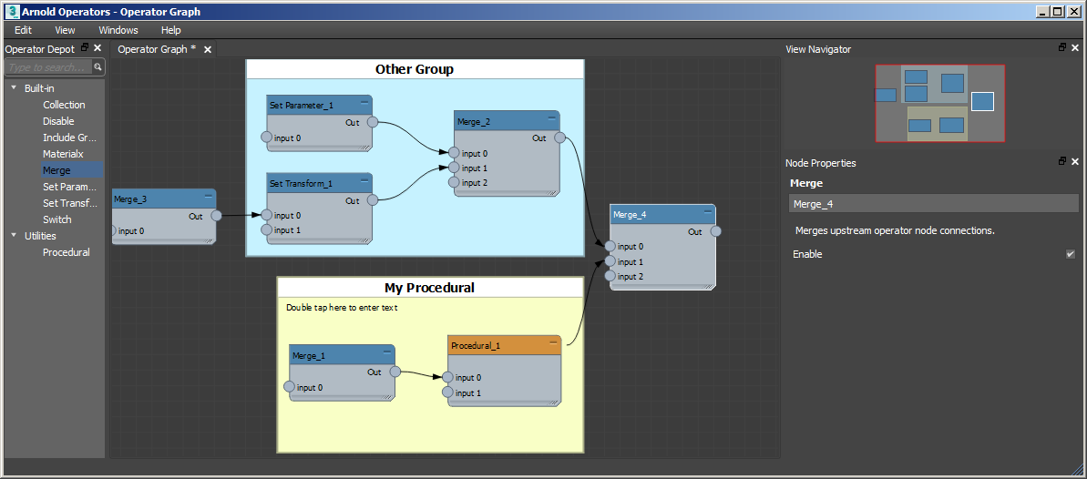

Operators Graph Editor window
Operators Graph Editor window (Arnold menu & Render Setup)

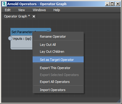

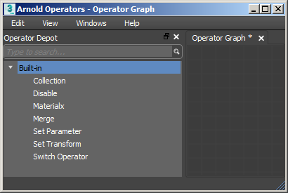

To add operators to the scene, you must first select Arnold->Operator Graph from the top Arnold menu. The core operators are grouped under the Built-in category.
A given Operator is set as the root operator by right-mouse clicking on it and selecting Set as Target Operator. The root operator is then framed in green in the editor.
Operator branches can also be saved to .ass file with RMB + Export This/All, and re-imported (or imported into another Arnold plugin) with RMB + Import Operators.
Operators are applied globally to the scene. Any Operator connected to the root operator or to any of its children is evaluated. Operators do not have a particular output type; they just operate on the scene.

The following operators are available:
  • collection Creates a selection expression that can be referred to by other operator nodes in the operator graph.
  • disable disables and enables nodes. Supported types are shapes, lights, shaders, and operators.
  • include graph Include an operator graph and shaders from a referenced file. If the operator is in a graph which is connected to a procedural, the included shaders and any shader assignments made in the included operators are relative to the procedural's namespace in order to ensure portability.
  • materialx Applies a MaterialX look. The operator supports native Arnold shaders and the MaterialX standard library.
  • merge Merges upstream operator node connections.
  • set parameter Set/override node parameters using assignment expressions.
  • set transform Set/override the transform matrix for shapes, cameras, and lights.
  • string replace Replace all non-overlapping occurrences of the match pattern on all string parameters for selected nodes. The match/replace can be targeted to a specific OS.
  • switch operator Switches between incoming operator connections by choosing which input index is enabled.
