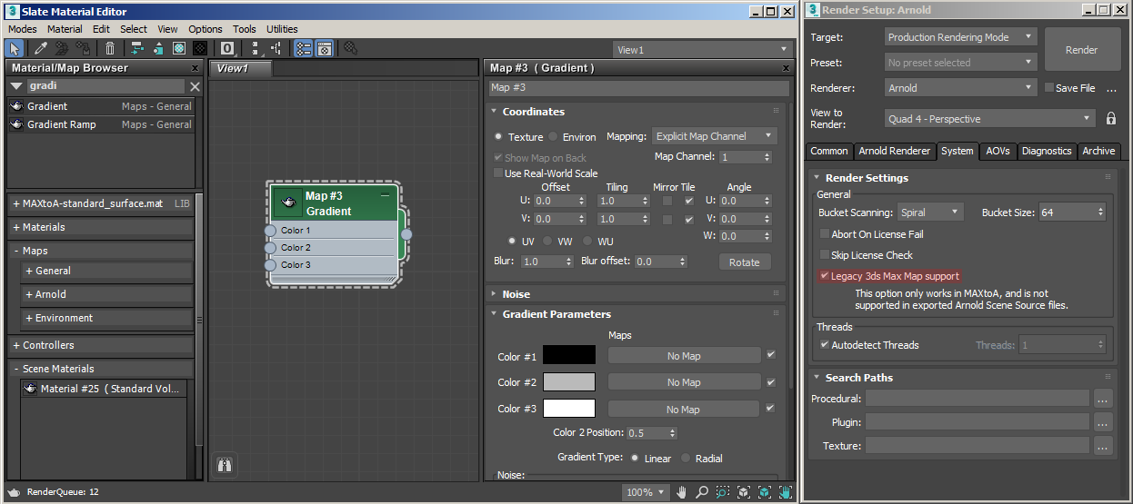

Note:
To use legacy shaders with MAXtoA, such as Gradient, you must enable Legacy 3ds Max Map support in the System tab of the Render Setup window.
