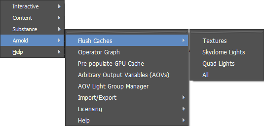

Flush Caches
If you need to modify texture while you are rendering, you have the following options:
- Use the Flush Caches ->Textures command.
- Disable Auto-mipmap and Auto-tile options while you are modifying textures. With this option, you will not have any pre-processing before each render.
The Flush Caches menu can be found within the Arnold menubar in the main application window

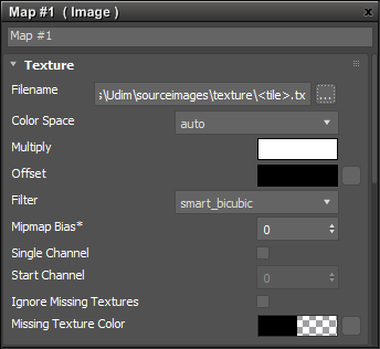

MAXtoA supports the following texture tokens, including both the <tile> (Mudbox) and <udim> (Mari) tokens.
Examples
| Token | Texture Name | Texture Path | Result |
| <tile> | texture _u1_v1.tx | texture |
_u1_v1 |
| <udim> | texture_v0001.tx | texture_v0001. |
1001, 1002, 1003 etc |
Tile
When using the
Image map with <tile> texture token
UDIM values are a way of representing the integer coordinates of a texture, from the coordinates of its bottom-left corner in UV space.
Image map with the <udim> tag
