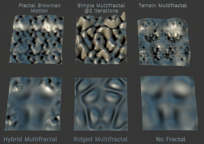

The different fractal types
Note: With the simple multifractal example, using fewer iterations (typically two or fewer) generally produces better, more predictable results.
