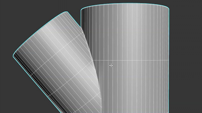

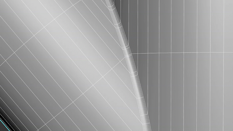

In this example, you will apply Smart Bevel to a hard-surface model after a Boolean operation to maintain clean corners and controlled edge transitions.

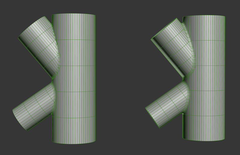

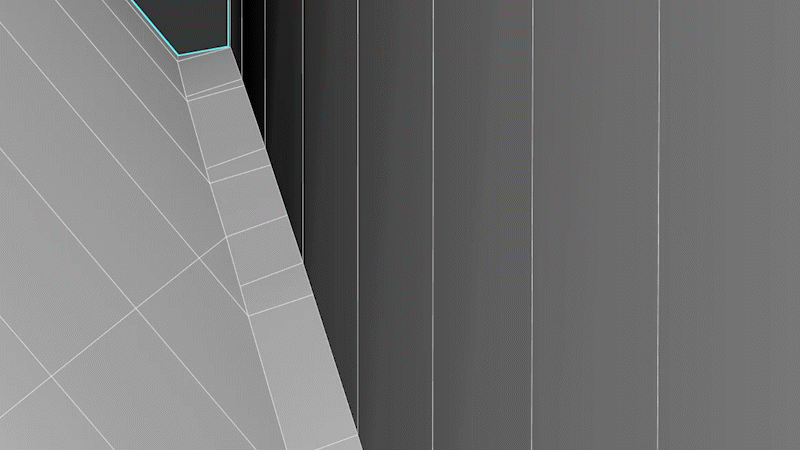

Chamfer (left) versus Smart Bevel (right)
Note the collapsed edges on chamfer compared to the clean geometry of Smart Bevel
