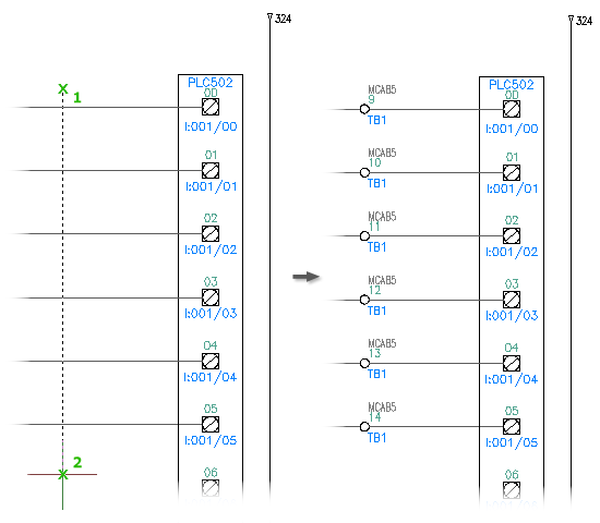

Insert and modify schematic terminals. Define multi-level schematic terminals.
Time required |
45 minutes |
Prerequisites: |
Copy all files located in |
Users\{username}\Documents\Acade {version}\Aedata\Tutorial\Aegs\Schematic terminals to Users\{username}\Documents\Acade {version}\Aedata\Proj\Aegs |
Note: Delete existing files in the destination folder before copying.
Follow the workflow topics listed below to accomplish these tasks:
- Insert terminals
- Assign terminal block properties
- Define a multi-level terminal
- Associate terminals
