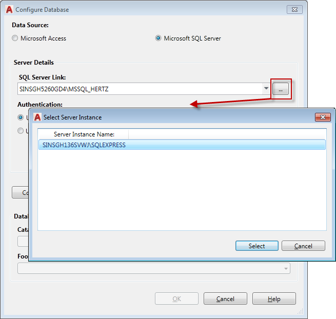

- On the Configure Database dialog box, select Microsoft® SQL™ Server. The default selection is Microsoft® Access.
- In the Server details area, browse to navigate and select the appropriate server instance for your SQL Server connection.

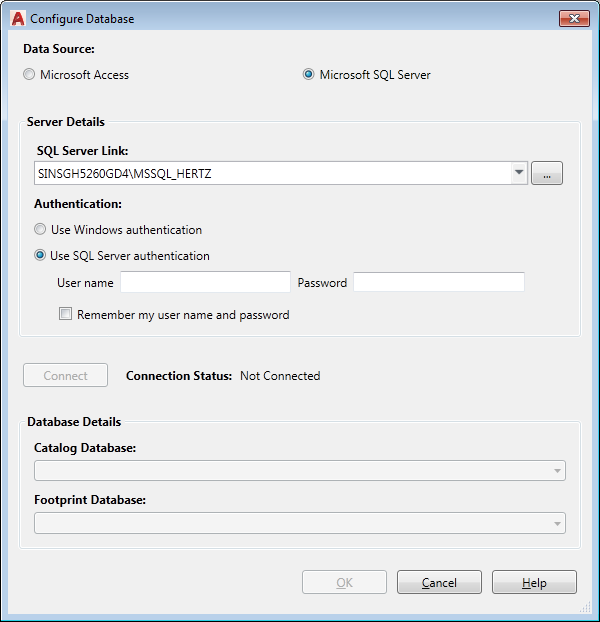

- Under Authentication, either:
- Use the Windows authentication.
- Use SQL Server authentication. Enter your user name and password.
Note: You can choose to select Remember my user name and password for subsequent sessions.
- Click Connect. Establishes your connection to the selected SQL Server name.
Note: Use Disconnect to log off, and then use a different user name and password for establishing another connection.
- In the Database Details area, select the catalog and footprint databases from the respective list.
- Click OK.
