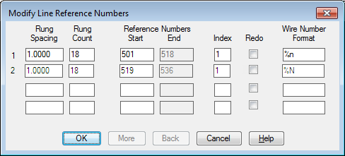

The Modify Line Reference Numbers dialog box displays a list of ladders in the drawing.
- Change the beginning line reference numbers for each ladder. Change the first ladder to 101 (column 1, line 01) and the second ladder to 201 (column 2, line 01).
- Click OK.
The reference numbers update along each ladder.
