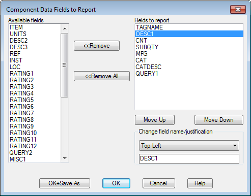

In the Report Generator dialog box, notice that 9PB-12PB are still listed in the TAGNAME column of the report.
- In the Report Generator dialog box, click Change Report Format.
- In the Component Data Fields to Report dialog box, select Desc1 from the Available Fields list.
Desc1 moves into the Fields to report list. These are the fields to display in the Component report.
- Click OK.
The Report Generator dialog box now lists the TAGNAME and DESC1 values from the active drawing.
