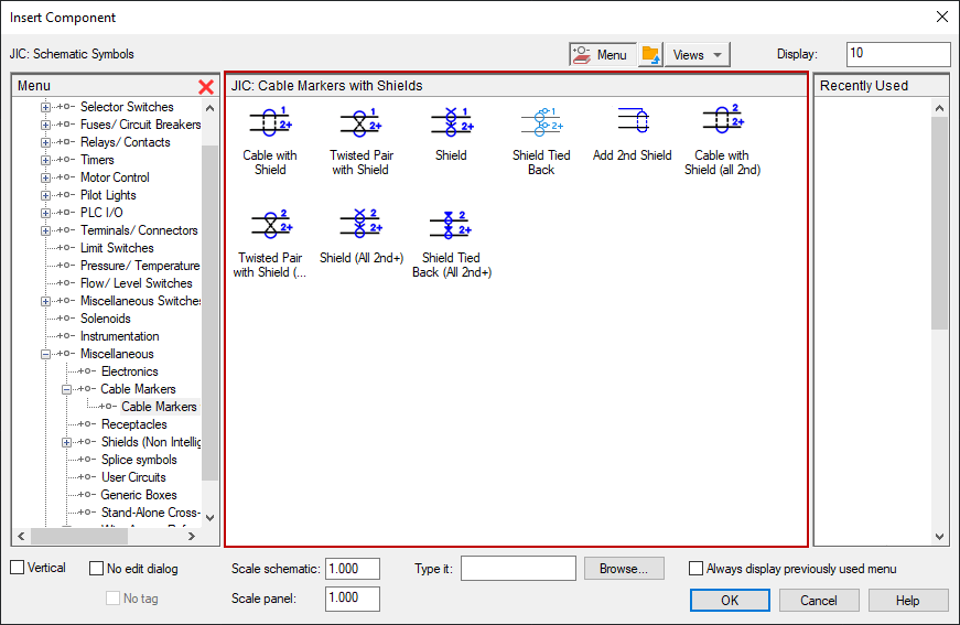

Cable Marker Symbols
AutoCAD Electrical toolset cable conductor marker symbols follow this convention:
- The first character is "H" or "V" for horizontal wire or vertical wire insertion.
- The next two characters are "W0." A zero (0) means that the symbol does not trigger a wire number change through it.
- The fourth character is either 1 or 2: "1" for parent marker or "2" for child marker.
- The remaining characters are not specified.
Examples:
HW01.dwg |
Parent cable conductor marker, horizontal wire insertion |
HW02.dwg |
Child cable marker, horizontal wire insertion |
VW01.dwg |
Parent cable conductor marker, vertical wire insertion |
VW02.dwg |
Child cable marker, vertical wire insertion |

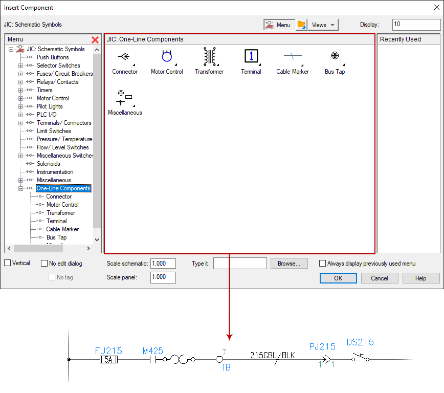

One-line Symbols
One-line symbols follow the same naming convention as schematic parent and child symbols. To make the symbol names unique, the one-line symbol block names have a “1-” suffix. However, the symbol name does not define the symbol as a one-line symbol. A one-line symbol is defined by the existence of a WDTYPE attribute with a value of “1-” on the symbol, or a value of “1-1” for a one-line bus-tap symbol.
The bus-tap symbol can have two functions:
- Provide an anchor point for the one-line circuit representation that begins at this location.
- Break into the one-line bus where the circuit connects.
On a dual circuit one-line template, there are three bus-tap symbols. One at the normal point where the circuit ties into the bus. There is another version of the symbol on each of the two circuit "legs", each marking the point where that part of the dual circuit starts. These bus-tap symbols allow various reports to report accurately on a one-line circuit, whether a single circuit or a dual circuit representation.
The following bus-tap symbols are supplied:
- HDV1_BT_1-.dwg - with “dot” for horizontal one-line circuit
- VDV1_BT_1-.dwg - with “dot” for vertical one-line circuit
- HDV1_BTT_1-.dwg - “tee” connection for dual horizontal circuit
- VDV1_BTT_1-.dwg - “tee” connection for dual vertical circuit
- HDV1_BTL_1-.dwg - “corner” connection for dual horizontal circuit
- VDV1_BTL_1-.dwg - “corner” connection for dual vertical circuit
A WDTYPE attribute with a “1-1” value, identifies a bus-tap symbol.

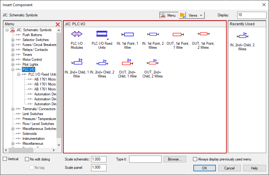

PLC I/O Parametric Build Symbols
These symbols begin with "HP" or "VP" (horizontal rung versus vertical) followed by a digit 1 through 9. The digit corresponds to the selected PLC module style or look. (1 through 5 are provided in the AutoCAD Electrical toolset library, 6 through 9 can be user-defined).
