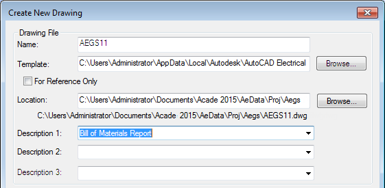

Create a drawing
  1. In the Project Manager, click the New Drawing tool.
  2. In the Create New Drawing dialog box, specify:
    Description 1:  Bill of Materials Report
  3. Click Browse next to the Template edit box.
    A set of templates (*.dwt files) installed with AutoCAD Electrical toolset contain settings for various kinds of drawings, such as acad.dwt and ACAD_ELECTRICAL.dwt.
    You can create your own templates, or use any drawing as a template. You can save a drawing at any stage of completion as a template file. When you use a drawing as a template, the settings in that drawing are used in the new drawing. The changes you make to a drawing that is based on a template do not affect the template file.
    AutoCAD Electrical toolset fully supports the use of AutoCAD template files. To make an AutoCAD drawing compatible with AutoCAD Electrical toolset, select an AutoCAD Electrical toolset command to modify the drawing.
  4. In the Select template dialog box, select ACAD_ELECTRICAL.dwt, and click Open.
  5. In the Create New Drawing dialog box, click OK.
    Note: You could click OK-Properties to display the Drawing Properties dialog box. This dialog box has options like the options found in the Project Properties dialog box. It defines drawing-specific settings that are maintained inside the WD_M block of the drawing.

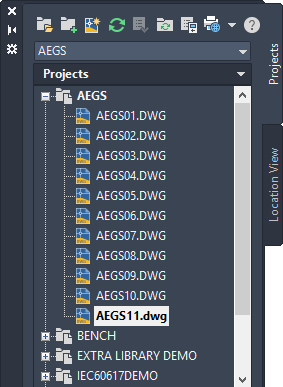

  6. In the Project Manager, double-click the project name (AEGS) to display the drawing files. AEGS11 is the only file in the list.
Add drawings to the project
    1. In the Project Manager, right-click AEGS, and select Add Drawings.
    2. In the Select Files to Add dialog box, select drawings AEGS01.dwg to AEGS10.dwg and click Add.
    3. When asked whether to apply the project default values to the drawing settings, click Yes.
      The Project Manager lists the files under the AEGS folder. New drawings that you add from this point on are added at the end of the drawing order. You now have access to the files required for the exercises in this book.
      Note: Two projects can reference the same drawing file. However, if both projects try to modify the same drawing with a project-wide tagging or cross-referencing function, it can lead to conflicts.
      The drawing order in the Project Manager determines how AutoCAD Electrical toolset processes the drawings during project-wide operations such as resequencing and wire numbering.
    4. Drag the drawings to put them in order, with AEGS11 at the end of the list.
      Note: The active drawing displays in bold text in the project drawing list. You can easily see which file you are working in.
