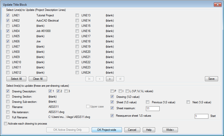

  4. Click Project tabOther Tools panelTitle Block Update. Find
    The Update Title Block dialog box displays.
  5. Select the project and drawing values to update on the title block.
    • LINE1
    • LINE2
    • LINE4
    • LINE6
    • Drawing Description: 1 and 2
    • Drawing (%D value)
    • Sheet (%S value)
    • Sheet maximum
    • Resequence sheet %S values: 1
  6. Click OK Project-Wide.
  7. Select drawings AEGS01 through AEGS05, and AEGS11 to process. Click Process v.
    Note: Drawings AEGS01 through AEGS05 are supplied with the WD_TB attribute on the title block for this exercise.
  8. Click OK.
