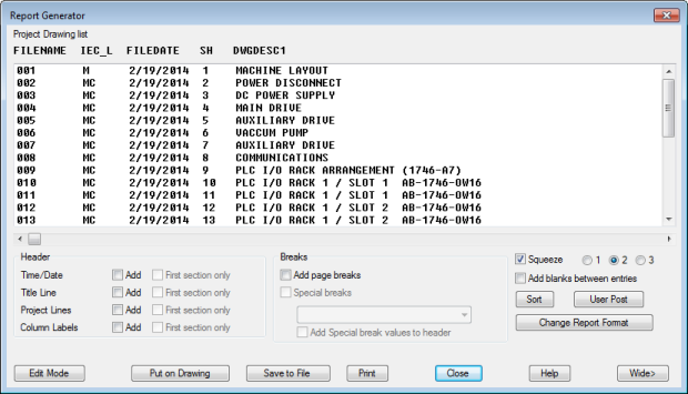

About the Drawing List Report
The Drawing List Report extracts the settings of each drawing in the project, and displays the report.
The report contains the following standard fields:
  • File name
  • File date
  • File time
  • Sheet value
  • Drawing value
  • Section
  • Sub-section
  • IEC project
  • IEC installation
  • IEC location
  • Drawing descriptions 1-3
If title block mapping is defined using either the WD_TB method or the .WDT file method, the mapped attributes on the title block are included as available fields for the report.
Note: Use Export to Spreadsheet and Import from Spreadsheet to edit and update drawing settings.
