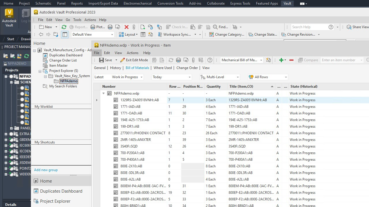

In previous releases, only the catalog number is used as the key to generate the Electrical BOM in Vault. Using only the catalog number as the key caused some issues when there are two symbols with the same catalog number but with different manufacturers, or with the same catalog number and manufacturer but with different AssemblyCodes.
In this release, AutoCAD Electrical introduces CAT-MFG-ASSYCODE key system (Catalog + Manufacturer + AssemblyCode) for Electrical BOM in Vault. The CAT-MFG-ASSYCODE key system resolves the issues pertaining to two symbols having the same key.
