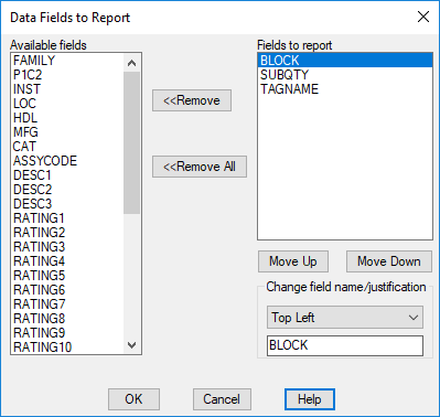

Specifies which fields to include in the report, the field order, and the field labels.
Find
Command entry: AESCHEMATICREPORT
Select Symbol List from the report list. Click Change Report Fields on the Schematic Reports dialog box.
List of Options
The following options are displayed.
Available Fields
Lists the available fields. Select a field from the list to add it to the cross-reference style.
Fields to Report
Specifies the fields to include, and the field order.
Remove
Removes the selected field from the Fields to Report list.
Remove All
Removes all the fields from the Fields to Report list.
Move Up
Moves the selected field one level up in the Fields to Report list.
Move Down
Moves the selected field one level down in the Fields to Report list.
Change Field Name/Justification
Specifies the field label and justification for the selected field.
